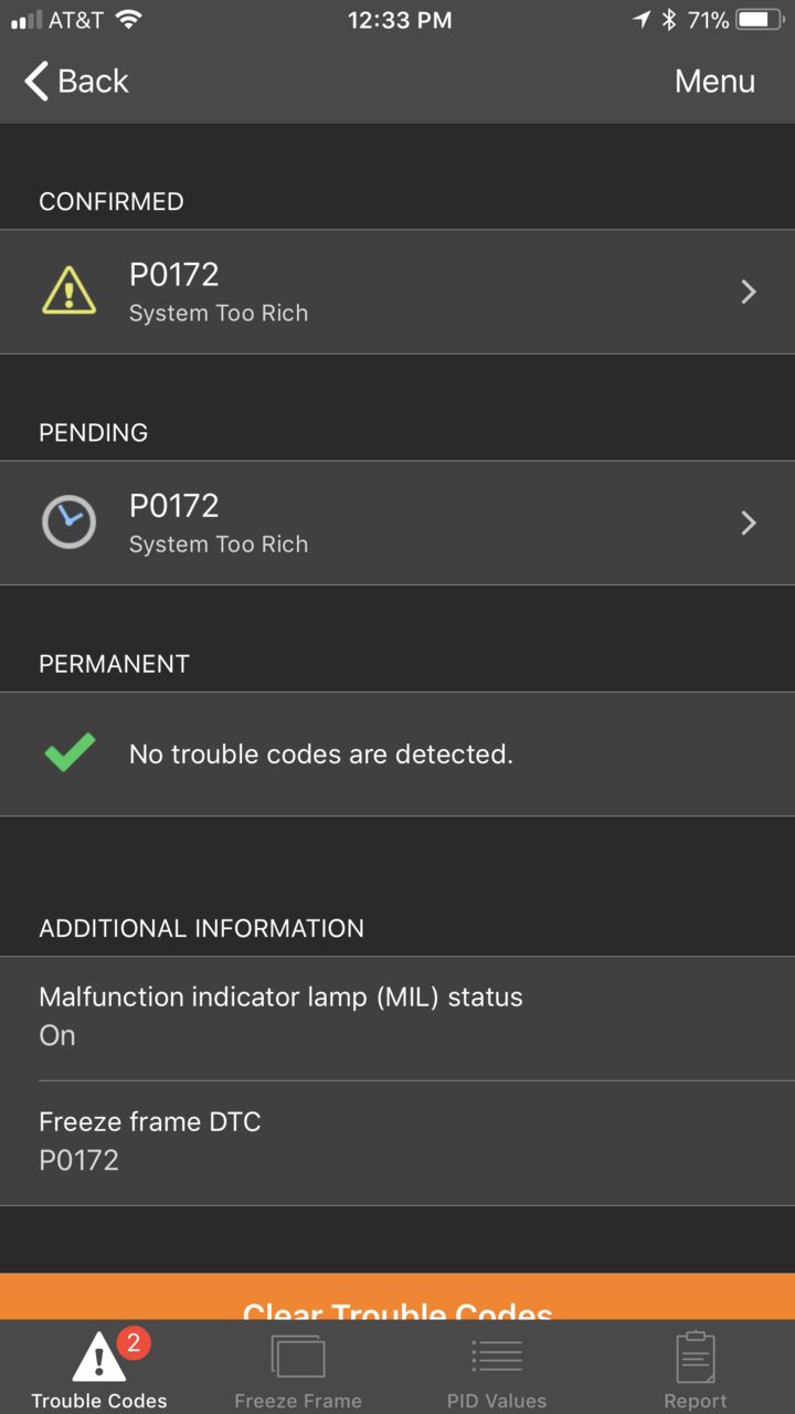

    I agree and I will be doing some kind of fuel management in the future plus I definitely want to use a PnP harness just not sure what type. As far as the low idle on startup that happened after changing the original IAC because it was leaking air of all things. I just wonder if there is some way I’m supposed to adjust the fast idle

    2rz and 3rz have no idle adjustment it is all controlled by the IAC which is controlled by the ECU.

    Speaking of. @arcenik sure enough today the check engine light came on. P0172 System Too Rich59C2E97C-CA91-4B68-B23C-CEE193229028.jpg

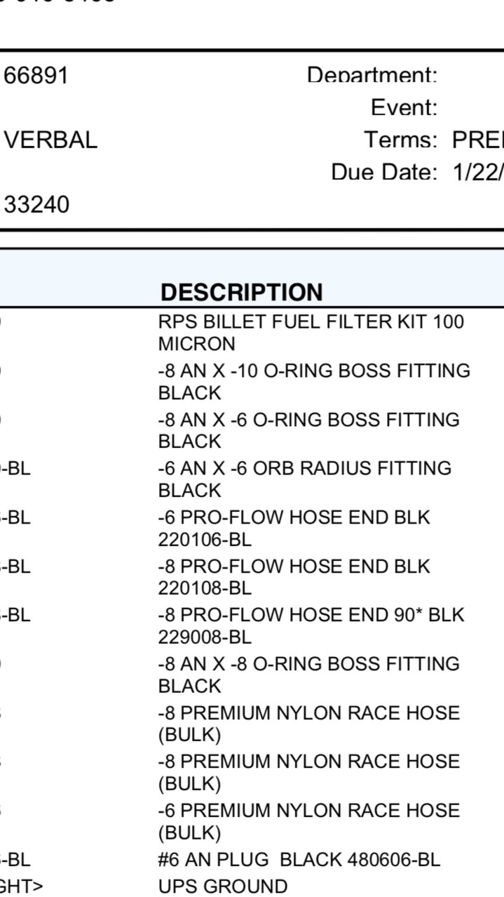

    I remember my last order of hose and fittings.
    I will have to make another before it's all said and done too..
