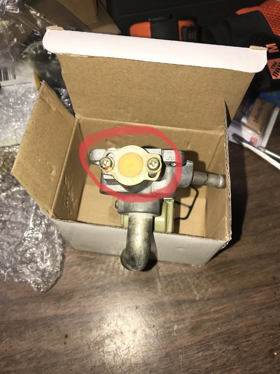

    This is the part on the IAC that I suspected was causing low idle on cold start and rich afr’s and needed to be adjusted. This is the original the new one didn’t match up. I finally got a chance to adjust it today and it seems to have made a difference but we will see after I drive it some more.
    MrCrowntown and Torspd like this.
