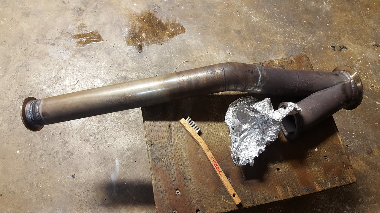

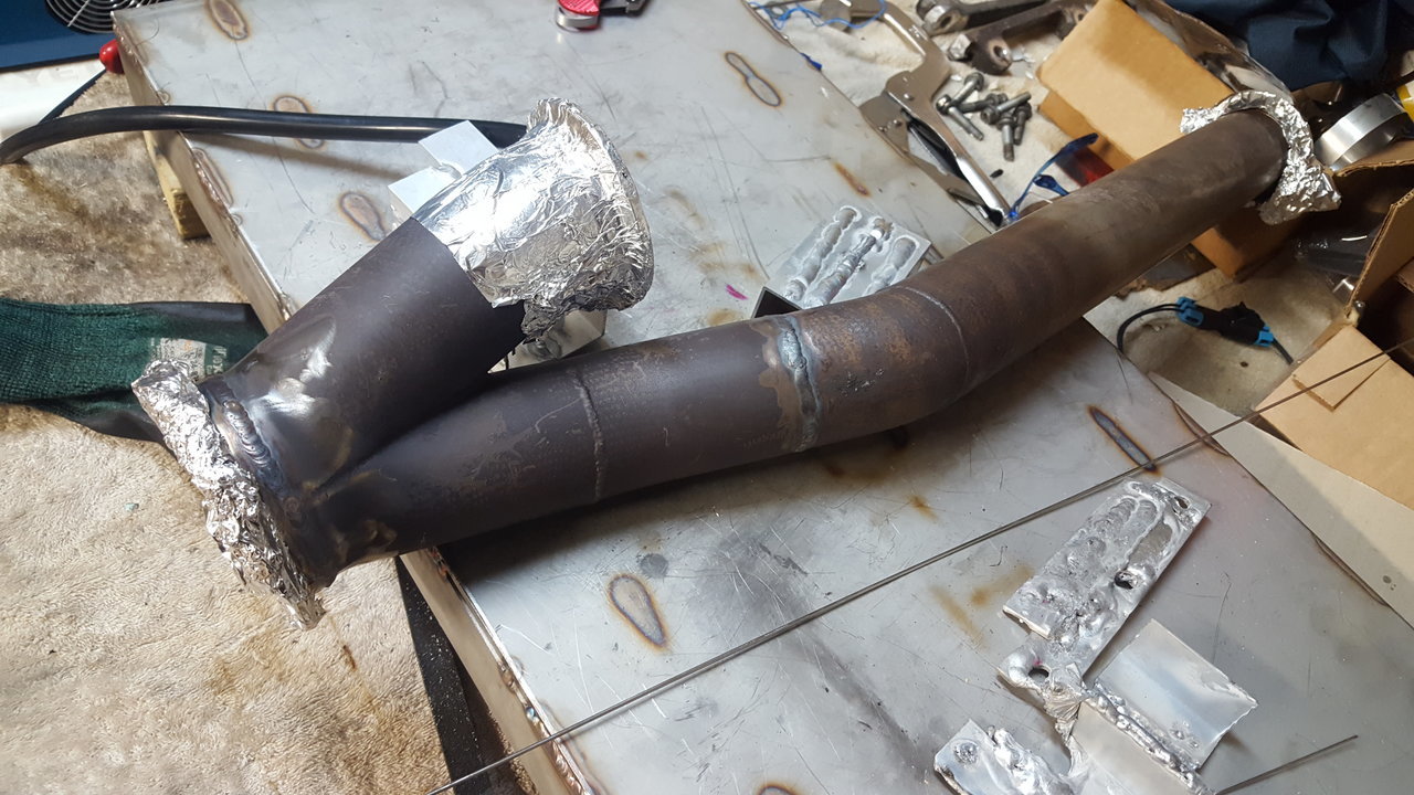

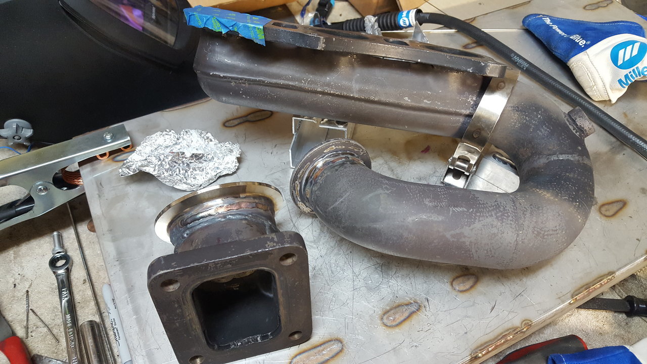

    Not the finest welds yet, but with each puddle they get a little better. These three components are completed. Only have the cross-over left, but have to wait until Monday to get more shielding gas.

    Love the test pieces laying around. Shows you're practicing!

    What's the foil for? Rolling your own crack pipes? :rasta:

    #backpurgelyfe

    So best recommendation I can give is clean more. Scotch bright the crap out of it. Then when you think it's enough go more then acetone. Purge wait for a minute or two then weld. You will find this will help a ton.

    The very early days of practice. :D They still have a purpose though. Keep them around to help hold the material in place.
    Poor man's backpurge caps. :rasta:

    Those were done. Turns out that my main issue, was not using a gas lense. Even with 20 CFH on a #8 cup, with a little bit more than a 1/4" stick-out, it still would be grey. Swapped in the gas lense, and a Furick cup, amd boom. Started getting the proper color. Which I should add, were some of your earliest recommendations.

    Gas coverage I can't stress enough. I have the furick bbw cup an have it at 35-40 cfh. Also tungsten angle and grind finish makes a enormous difference also. If you have any questions or whatever just hit me up more than happy to help you get those weldporn welds goin.

    I don't have the BBW yet. Just the #12. I was using 25 CFH, but not near the stick-out, since I was running low on gas and needed it to last.
