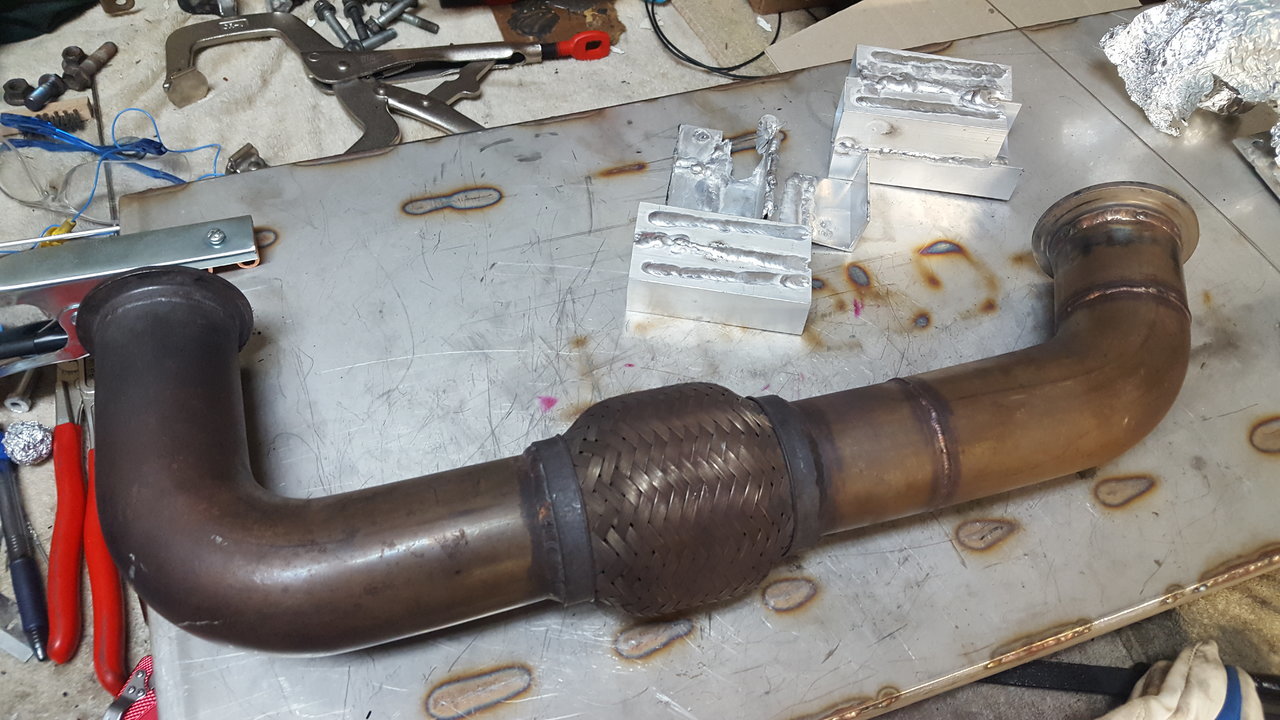

    Managed to fly to the gas suppply and snag another bottle of Argo, before I ran out of time. Cross-over completed. :woot:

    Welds are looking clean!

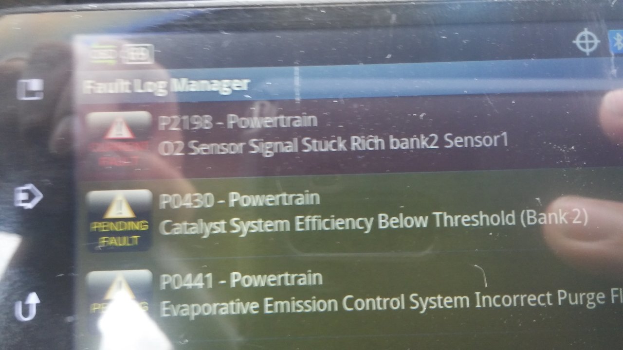

    So im guessin a do have a vacuum leak somewhere still or a bad sensor. I have reset the code since i "fixed" the tune and it still comes on after ~20 miles. It does lean my fuel trims out a lil. Like really close to 0 at cruise actually, but after my truck warms up, stft are non existant.

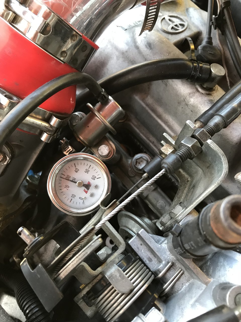

    Same just bogging on the freeway plus an issue with barely idling right at start up but today I noticed this which is very concerning.
    As I was typing this I was thinking that I did change the FPR back to the original thinking it was ok but noticed it was 43psi instead of 50psi like the new one so I guess I could change it and see what happens otherwise it might be the pump which is new from URD.

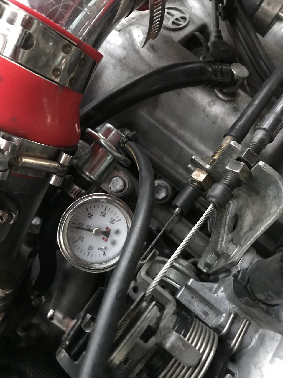

    I changed the FPR note the vac hose pointing a different direction on the new one and no difference I’ll just have to stay out of boost.58E337CA-1E42-4651-83A3-8E6B2D02A3AB.jpg

    I can’t find any solid leads on why the fuel pressure is less than 30psi but it may have started today on the way home from work I noticed at WOT bogging and afr’s high (lean)
    Fuel Pump (New DW200 from URD)
    FPR (New)
    Fuel Filter (again it’s new)
