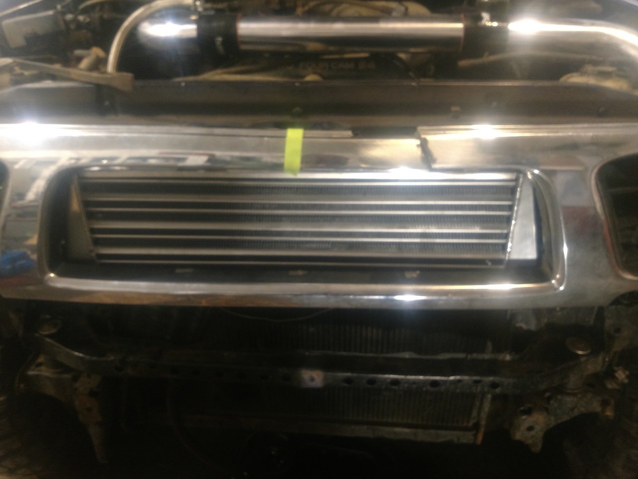

    battery and coolant overflow will need to be relocated. the hood latch support needs to be removed and the latch itself trimmed. seems real floppy without the support so il have to so something about that. could always go with hood pins too.
    other than that its literally just a 90* silicone joiner at each end that goes through a hole i cut between the headlight and rad. i can only see this working with the 95-97 headlights. its tight. the tubing in pic needs to be shortened.

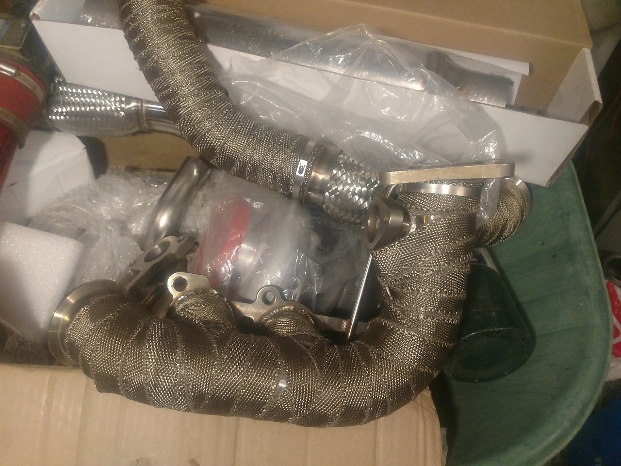

    the manifold studs i mean. most of them came out but 3 are giving me a hard time.

    Can u put a nut over it and weld the nut to the stud?

    he did that 4 times he said

    Those are never fun. An easy out is your best bet at this point.

    Room to get a propane torch in there, to heat expand things, then wrench them off?

    read post again ;) used a MAP gas torch yes. All studs came out with the nut on drivers side. not a single one wants to come on passenger side. thankful to the 1" bodylift for giving me that extra bit of room to work with.
