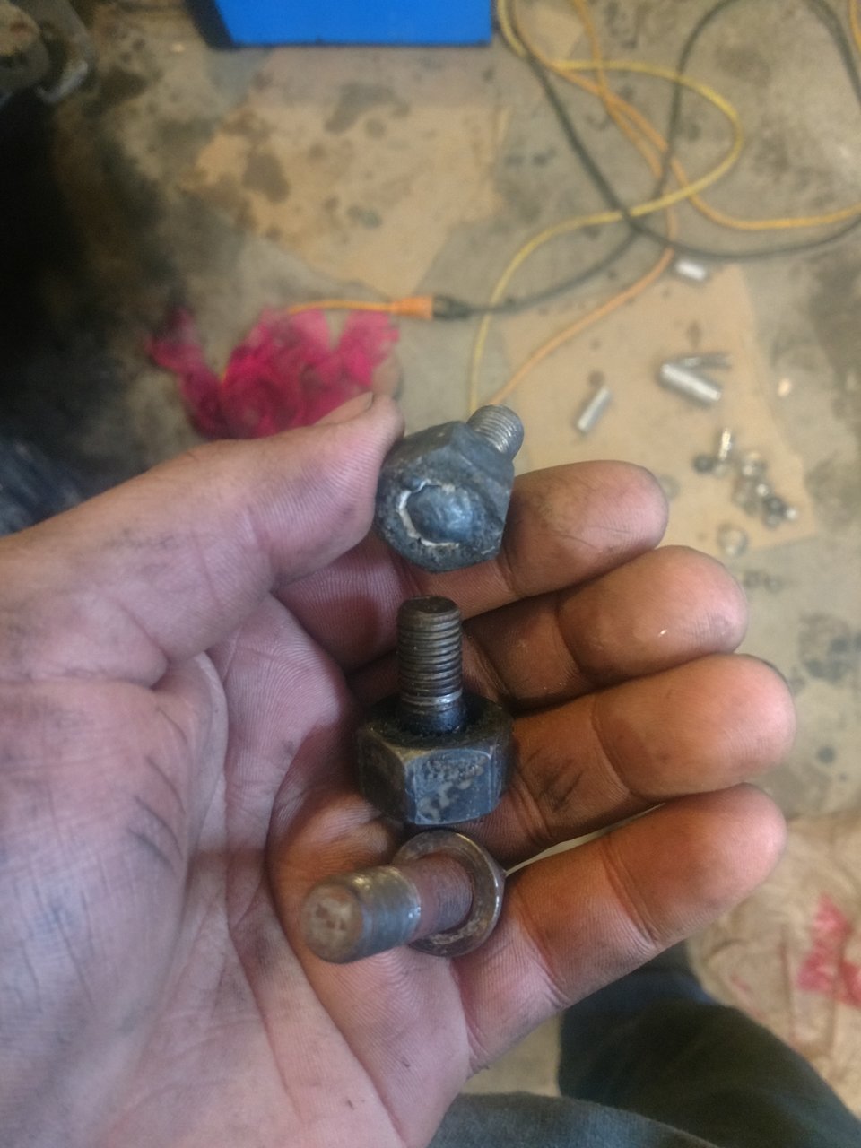

    2 days and about 40 nuts welded n snapped off later i got 4 more studs to get out ahaha.

    I'm lucky living in desert climate. Looks like someone is going to get a tub of anti seize.

    Anti-seize is definitely in his future, for exhaust stud install.

    i put antisieze on every bolt i take off of this thing

    I believe you. 100%. Too bad the factory doesn't though. This is your first time removing them correct?

    first time yea. all the drivers side came out with the nuts. not a one on the drivers side wants to come.

    50/50 mix of acetone and marvels mystery oil thoroughly mixed let to sit and sink in overnight. That is better than wd40 or PB penetrating oil in my experience. Did you try screwing on two nuts (to one stud), tightening them to each other and taking out the stud that way?
    EDIT: and why can’t you just leave the studs in there and just slip the new exhaust manifold flange holes over them and use a nut to tighten it down? IIRC I reused a couple stuck studs when I did my CX headers

    the studs that are stuck in are already snapped. rest came out with the nut.
