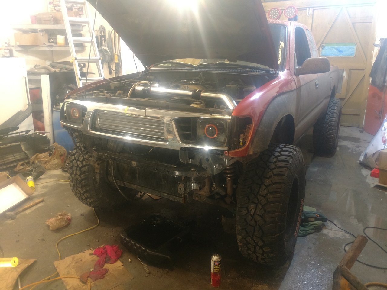

    im basically at a loss with getting these studs out. ive welded probably 50 nuts on. used map gas and propane torches. quickly cooled the stud with head hot, hit them with a large hammer. a weeks worth of soaking in every penetrant i could get my hands on.
    has anyone ever successfully drilled out these studs without removing the heads?
    any advice at all is appreciated.

    A 90 degree drill may would work, or if it's too bad that and a rethread kit.

    Ive gotten a fucked stud out of a duramax turbo pedestal this way. Lol but heat that sucker up try to get it red hot. Stud and around the outside of the hole. let it cool for like 15 seconds and take a stick of candle wax to the stud and block. should melt and suck the wax in between the male and female threads. Have that nut already welded on or i think my buddy had a snap on extractor kit that i used to turn it out i cant remember. Hopefully you haven't started drilling and i havent read all your posts on the issue so this might not be helpful

    Whats size intercooler is that?

    28x7x2.5 offset inlet and outlet
