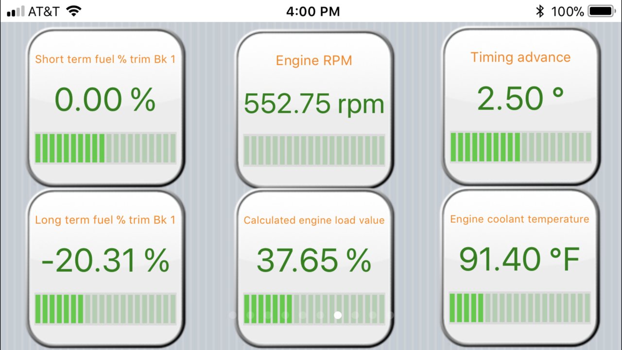

    Wait you're running 440s and no piggyback? No wonder it won't idle!
    Yeah don't sweat any tuning issues until you get that FIC wired in. There's no way your stock ECU can deal with 440s.

    I’m running 440’s w no ecu tuning and it ideas fine. Only “issue” is it’s extra rich once it hits open loop

    Its an issue with the IAC I think but the afrs are at 9-10 until it warms up a little plus I have an exhaust leak at the downpipe before the o2 sensors.

    For real? What's your idle LTFT? What elevation and and ambient?

    I know you were looking for @boostedka LTFT but here’s mine :D 175AD737-5DD4-4CC7-8A3E-EA754946BE02.jpg before it’s warmed up[/ATTACH]

    Numbers that I don't understand :goingcrazy::goingcrazy::goingcrazy::goingcrazy::goingcrazy::goingcrazy:
