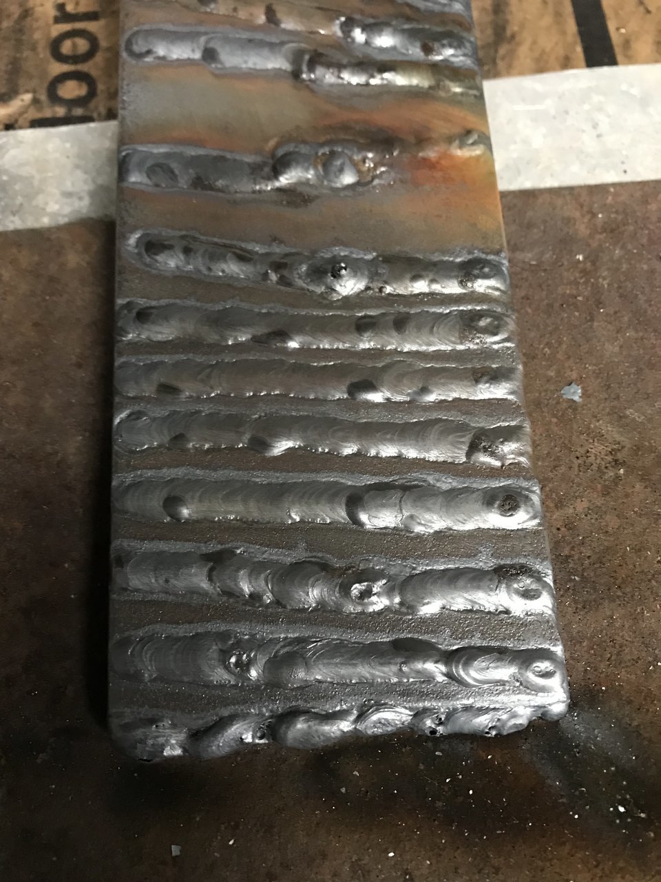

    A #7 using 25 CFH? You should be able to get away with 17-20 with that size. The larger cups, around 12-16 require 25-30.
    However, a little extra coverage doesn't hurt.

    I suggest a finger heat shield, will allow you to slide easier with support. Also, 2-3 different size rods.
    If just practicing there’s no reason to turn the amps up just to lay a line.

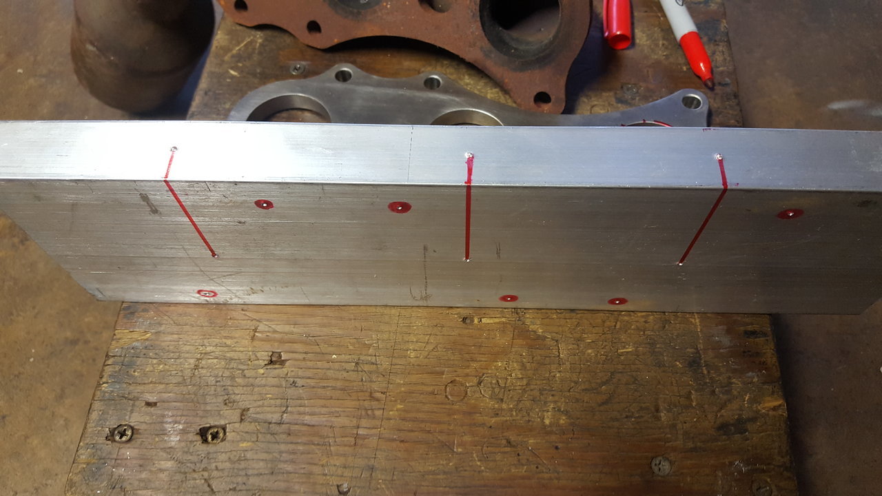

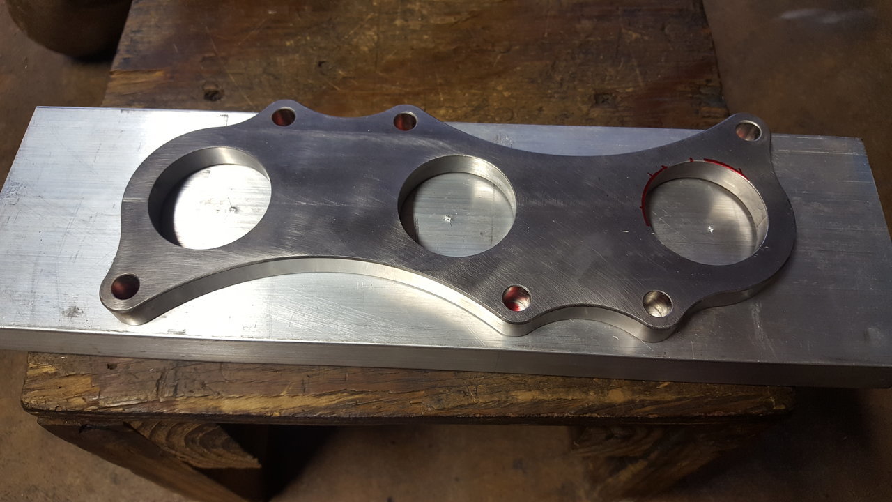

    Got this in the worx:

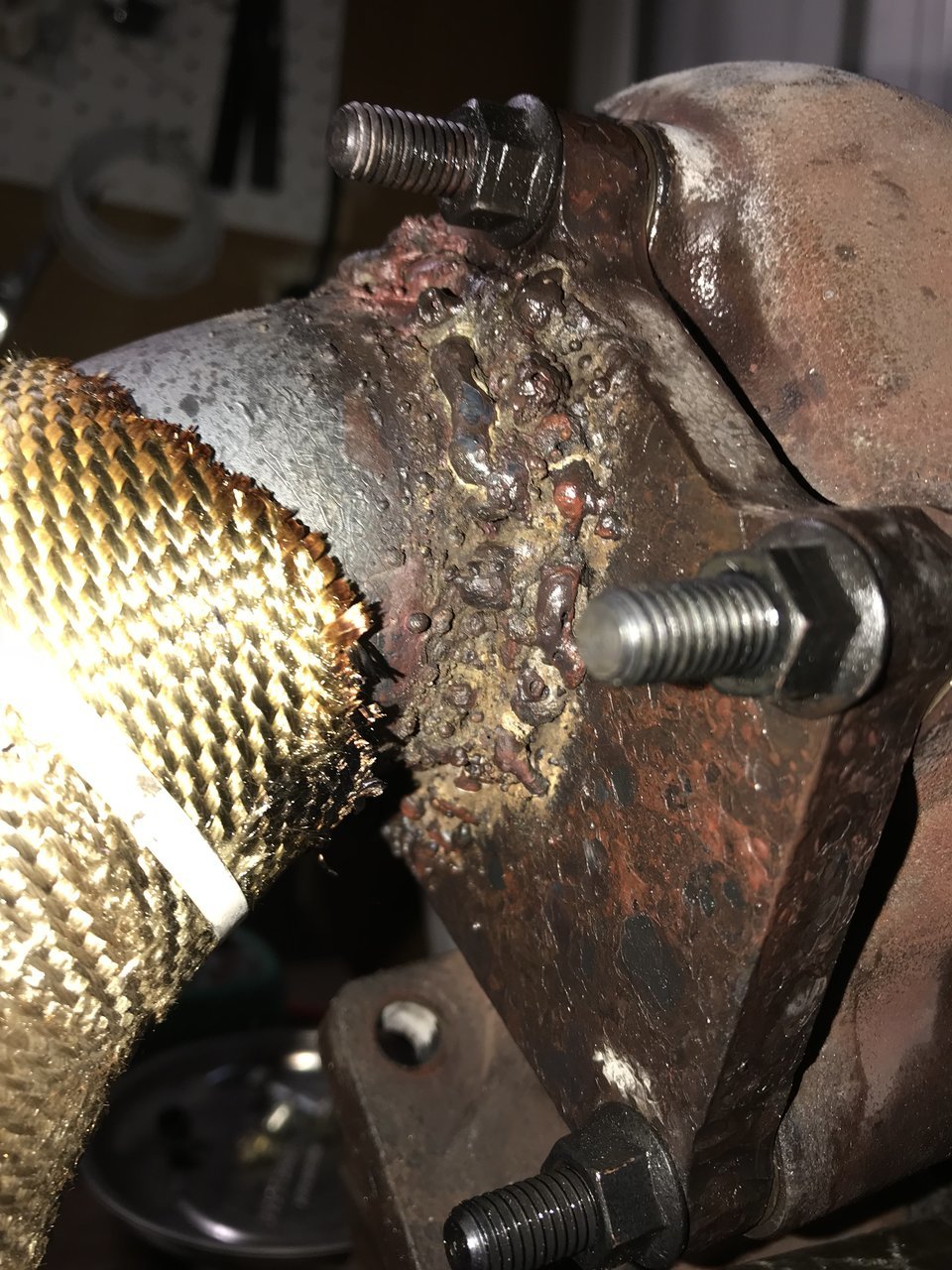

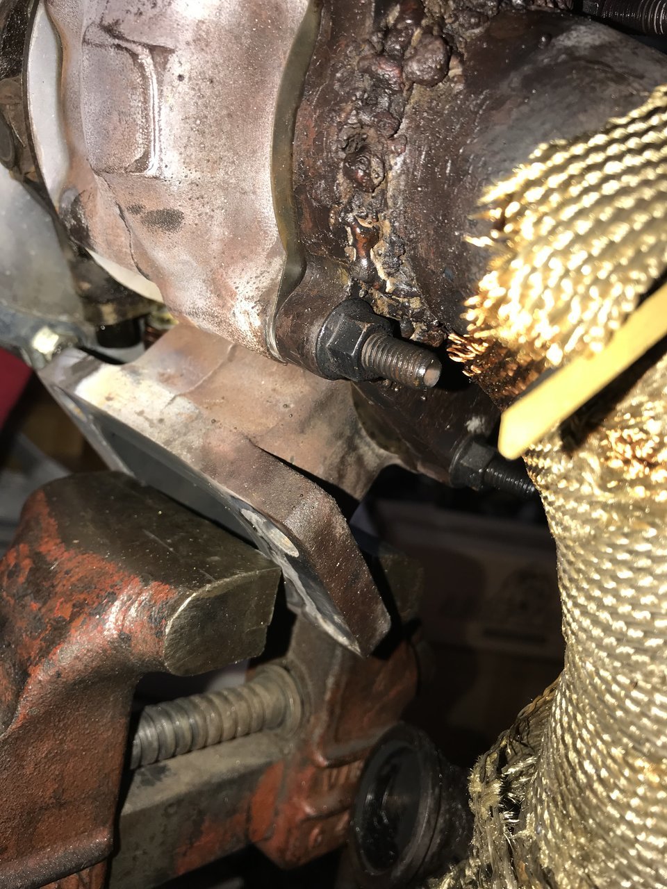

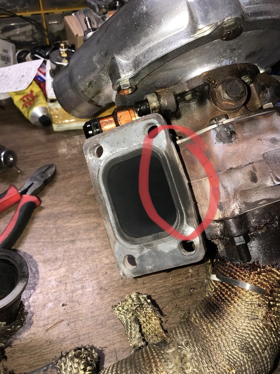

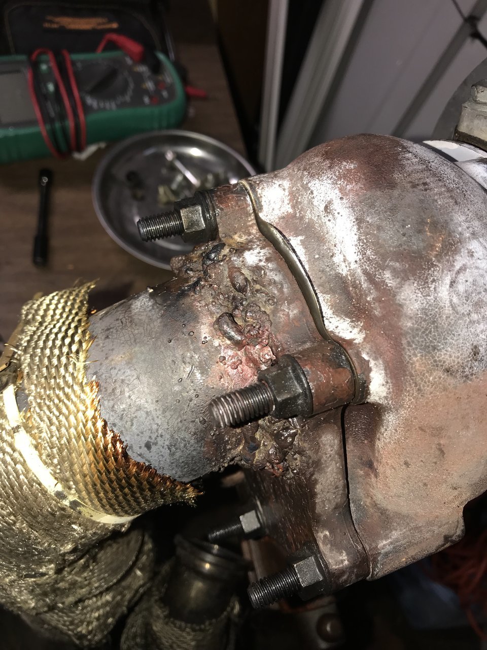

    I took the turbo and downpipe off today looking for the exhaust leak and I think it was where the turbo bolts to the exhaust manifold. It doesn’t look like the flange is leaking enough to re weld another flange.

    It looks like a mess but I don’t feel like drilling out those studs and putting helicoils again. Still I think the major leak was the turbo to exhaust manifold.

    Exhaust leaks make it idle like crap.

    I’ll take it to work and weld the flange/downpipe area in the places that look like they may have been leaking.

    I had a small leak at my internal wastegate joint. Once I fixed that it the motor is really happy.

    Definitely leaking there. Can you take a straight edge to the turbine inlet, and then to the exhaust manifold flange? You'd be able to determine which is warped, and can then sand it down flat. A copper gasket will also help, but sanding is a lot cheaper if you already have the tools.

    I did a little sanding this morning on the turbine housing and some welding around the areas on the downpipe that looked like they needed it.

    Good deal. Still make sure to sand the flange on the exhaust manifold. I say that due to the leak being on the exhaust manifold side of the gasket. Path of least resistance means the exhaust manifold flange is the likeliest culprit for being warped.
