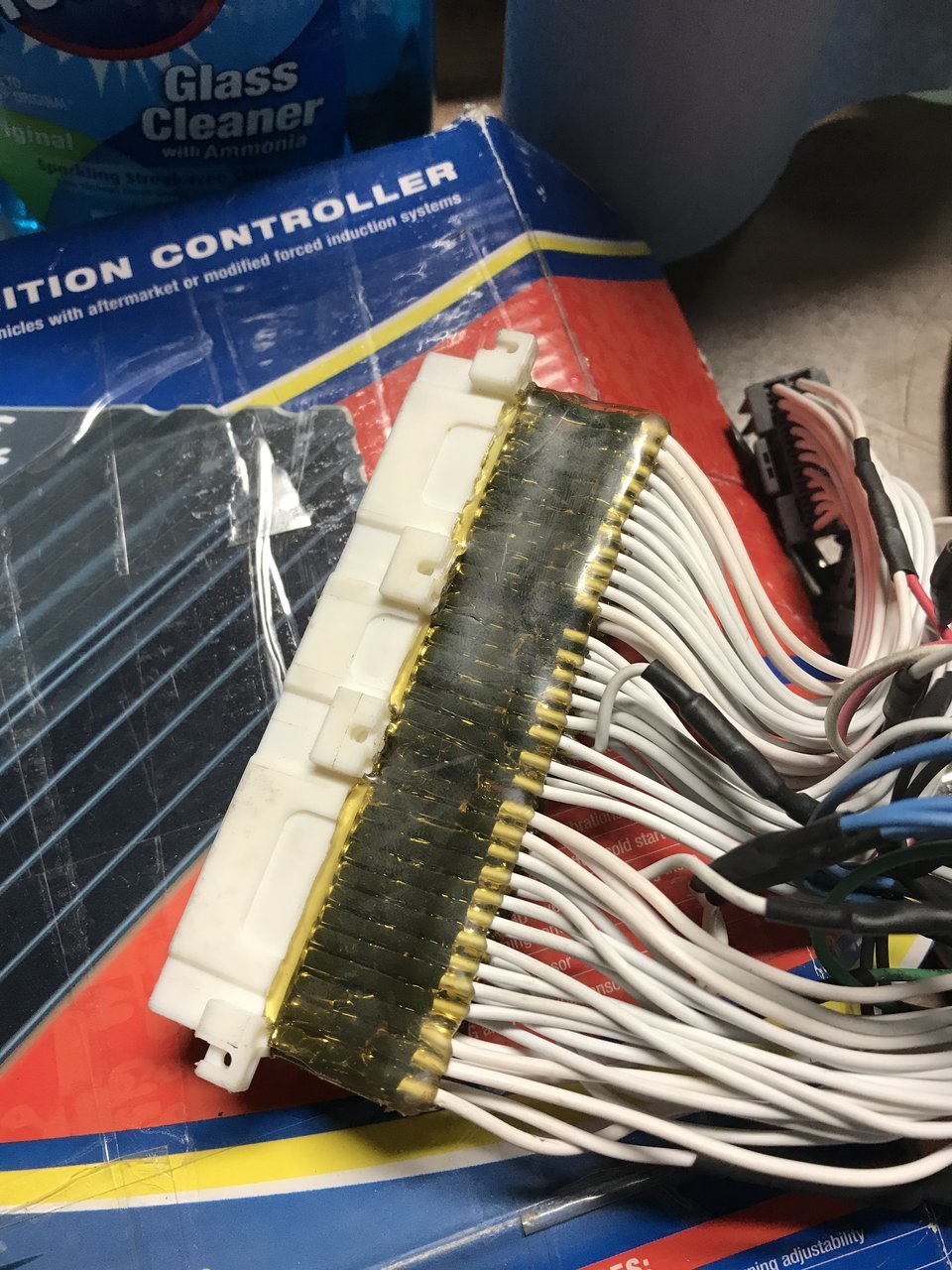

    On second thought depending on the new harness I’ll have to cut and solder after all228E1412-2F6A-49A9-8F70-5442F78C90B9.jpg

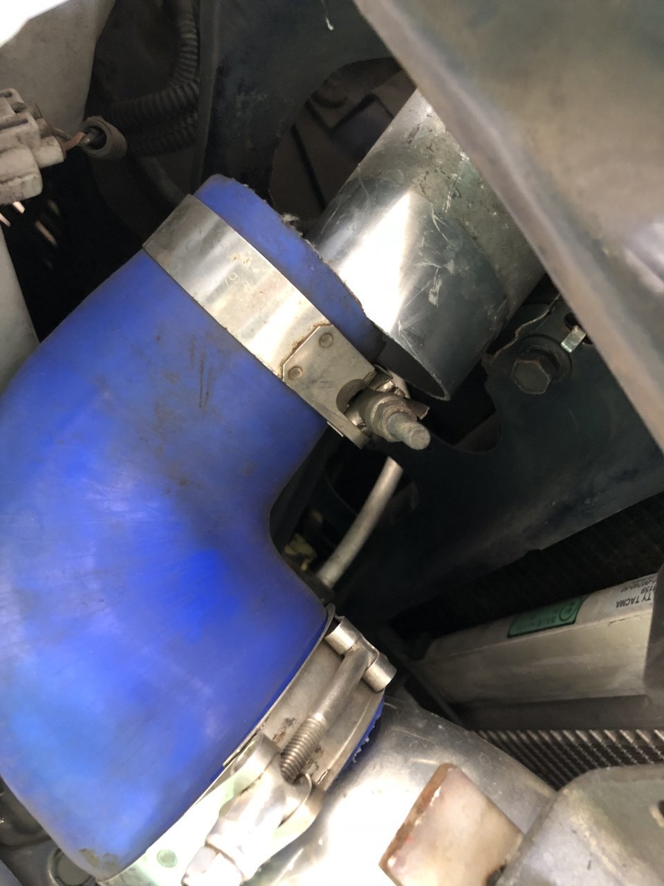

    No wonder I misfired. T-clamp broke. I’m surprised it didn’t stall under boost.

    Nothing is more fun than waiting for windows updates, and not recognizing com ports. Never tried it but could run a virtual machine probably. Luckily it old crap laptops are the best for it. Tuning software is very lightweight.
    Done that a few times. I need to flare my tubes. Mine keeps moving, but I have 100hp less.

    Which brand is that clamp?

    I put a few tack welds in the end of mine to give the t-bolt something to grab onto. I haven’t had any blow off yet

    This is what I was about to say.

    :anonymous: I can’t weld aluminum.
    I could make a ghetto flare tool. It’s been a year since it last happened. Solid motor mounts I think was the fix.

    I don’t remember. It’s been a long time ago. I gotta get a bead roller
