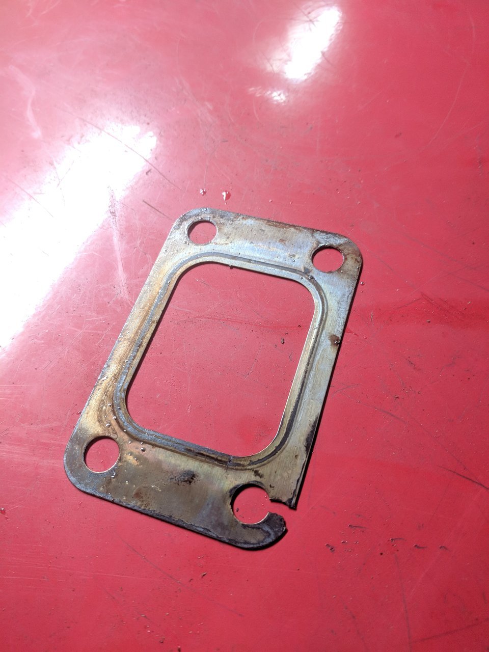

    Well, my intake manifold gasket actually wasn't the issue. Took the manifold off (with the turbo and DP together) to find no signs of leakage. Replaced the OEM one with the Felpro anyways, since it was thicker and visibly better quality. Upon inspection, I found that one of my studs backed out pretty badly, and the other one next to it was loose. Took off the turbo to inspect closer- and saw the T25 gasket was the issue...Luckily I had a few extra new ones, just in case! You can see below what happened. Note- this was after only 1500mi...
    Anyways, got the studs tightened in much better now, new gasket, torqued it all back down then header wrapped my downpipe with the DEI Ti-Wrap. Easy as cake! I also installed my turbo blanket, since I've been forgetting about it since I put the turbo in lol. Looks much better, and keeping my underhood temps down is key. Feels good to be able to build more than 2psi of boost again! :bikewheelie2:

    i stopped running gaskets between the manifold and turbo. i got tired of blowing them out and having to change them. didnt have any issues without them. that is if the flanges are machined nicely

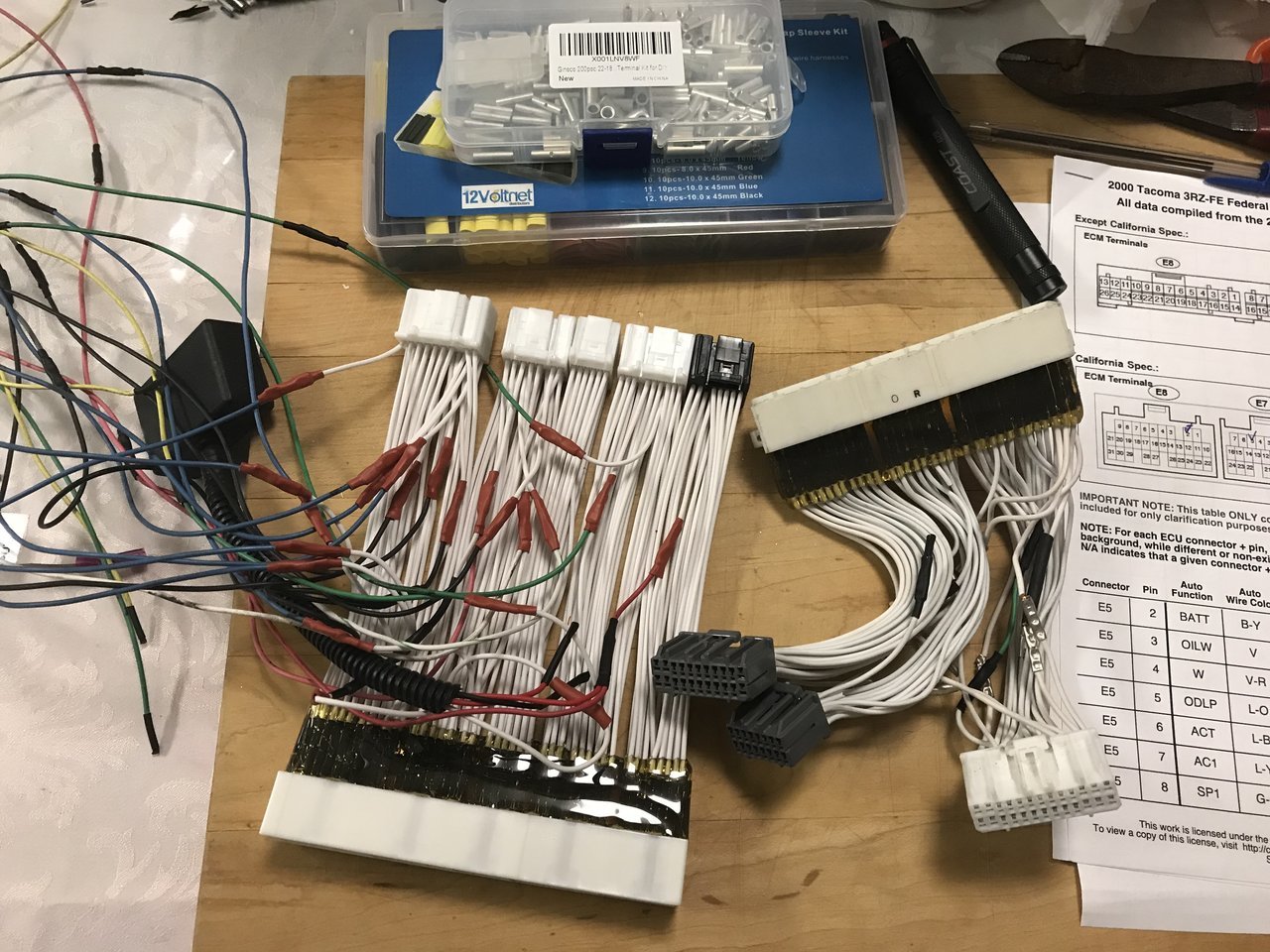

    Yes thx I’ve converted all of the wires from the 2rz to the 3rz harness on paper and just started the actual process.

    I just barely started 18 more wires to transfer over. I'll try to finish tonight and I'll take a pic. I won't be able to install it yet plus I need to finish filing the exhaust manifold but I'm ready to start tuning just not the truck.

    Is that a multi-layer steel gasket?

    The gasket that came with my LCE header was multi-layer steel.

    And here it is. I just need to make sure if the cam sensor needs to be hooked up or not.
