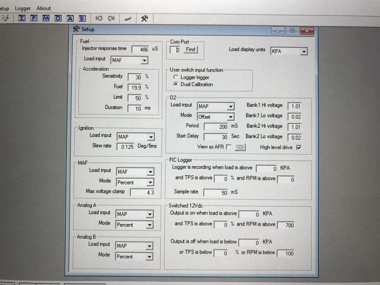

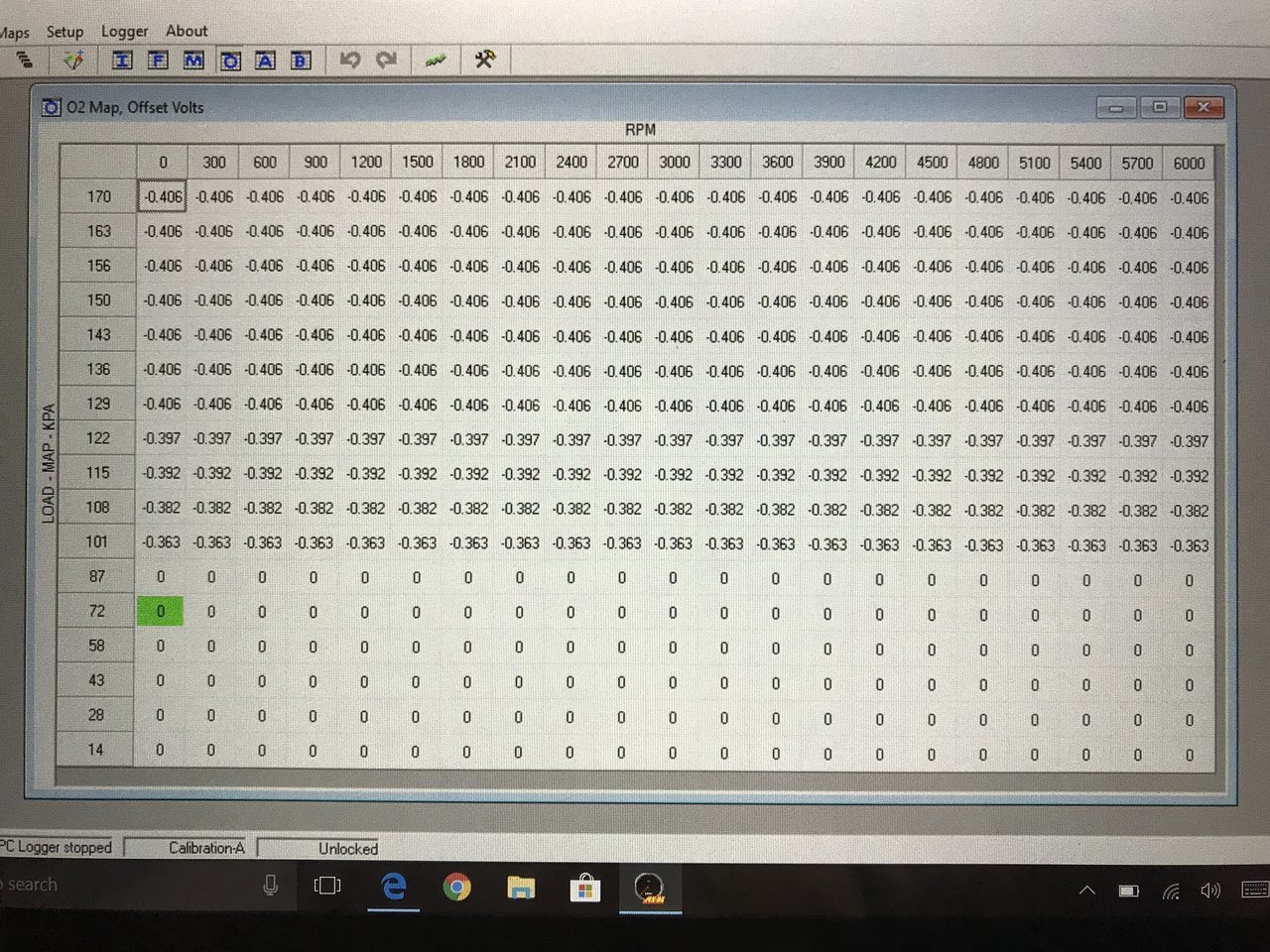

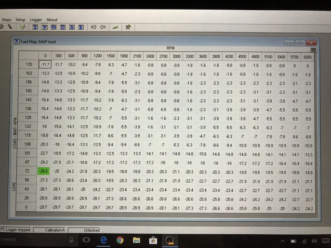

    WOW !! I’m lost. Does this look like your maps and setup @arcenik I think I downloaded your setup but I’m not sure.

    Yup that’s my map you could start with that and just scale the fuel map to start with.
    I would just highlight the whole fuel map and raise or lower it till your idle trims are close to zero. It would be a good starting point.
    Most likely you would need to get the map more into the negative. As I was running 320cc injectors with that map.

    Mine is around -53% at idle with 550s FWIW
    The setup wizard thing it has built in will get you pretty close too. Just put your default size injectors, and the new size and it'll scale them pretty close. At least startable.

    I'm at like -44% on 550cc's
    I found it got close but subtracted too much

    This might be better since I’m running 440s. If by default you mean stock that would be 289cc
