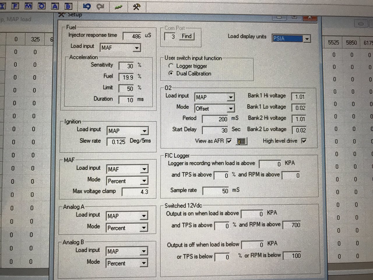

    Does anyone have a suggestion on the best settings :Dimage.jpg

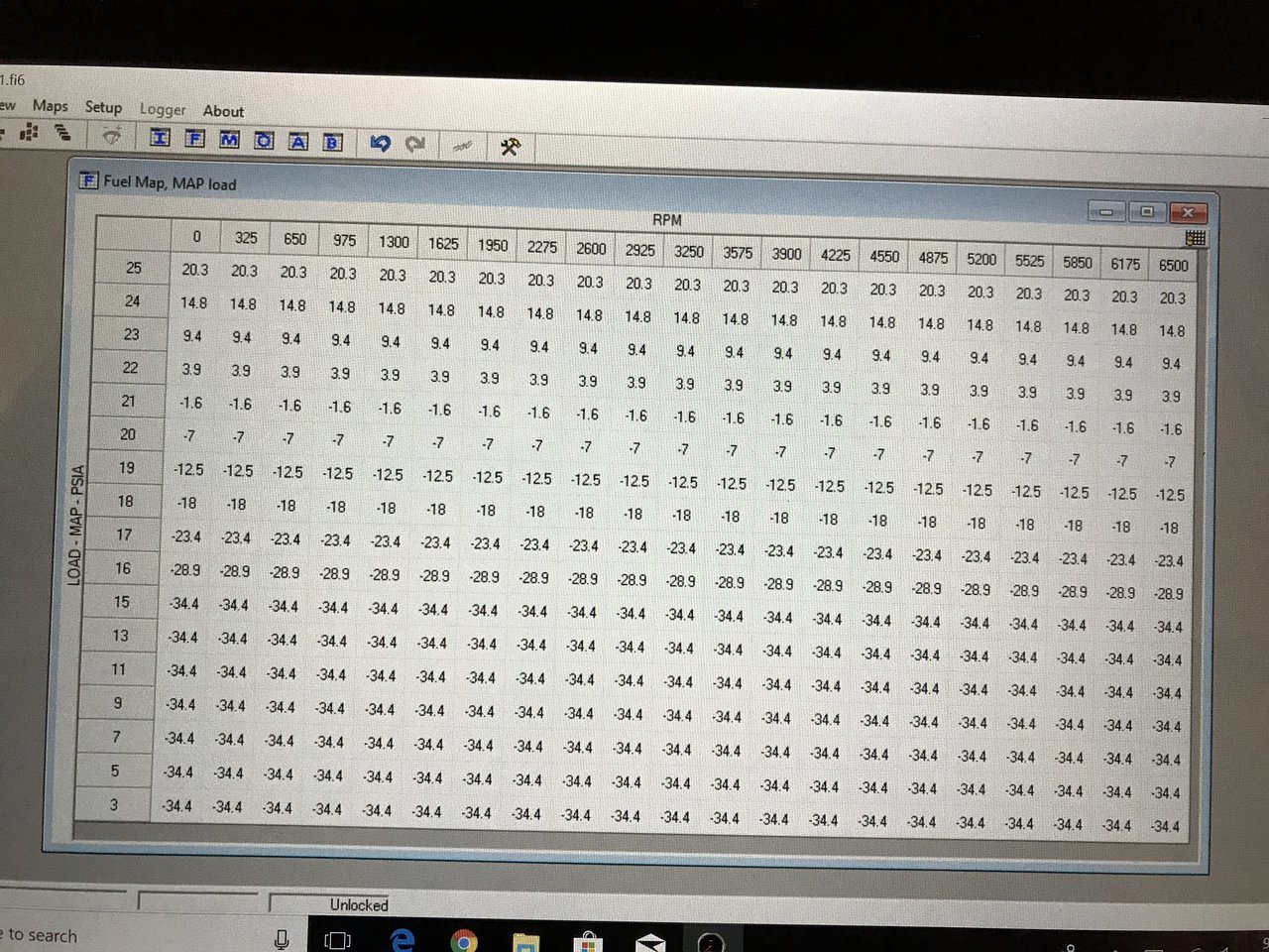

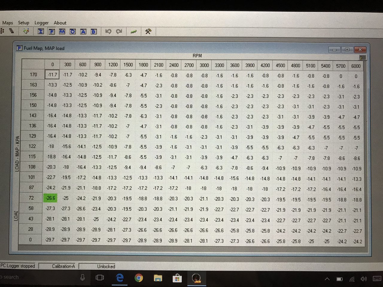

    I created a base map putting in 440 new injectors 289 stock inj. Max rpm 5500 max boost 10psi and this is what came up. It’s way different than @arcenik’s map.
    image.jpgNew^^ @arcenik’s down below 37723B1C-E2C4-4D63-A02F-3746AED08629.jpg Tomorrow I’ll connect the AEM to the truck do the calibration and see what happens :notsure: this has me nervous

    The base map is just to get you running. it will change dramatically when you start tuning.
