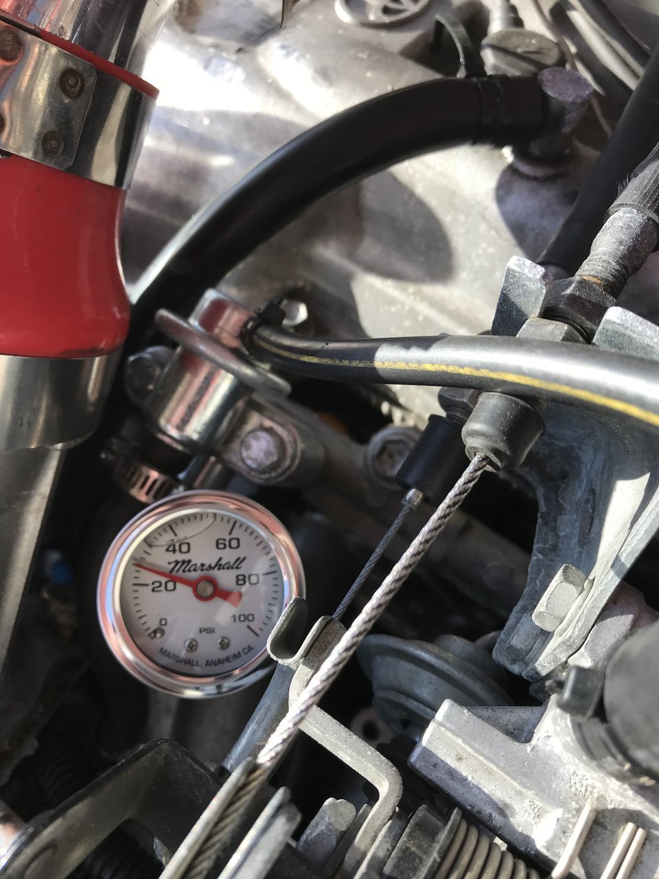

    Here’s something interesting though if anyone remembers I was having a problem with fuel pressure being too low I changed the fuel pump the fuel filter the fuel pressure regulator and gauge thinking that it was the gauge. Today I drove my truck after it sat for a while everything seems OK but the fuel pressure is low again. WOT afr’s are 9.0-10.0 :notsure:

    On the 5vz, the regulator does NOT get vacuum, it will make the fuel pressure lower. It only needs to reference atmosphere, or in your case, a boost only source. Is it hooked to vacuum source?
