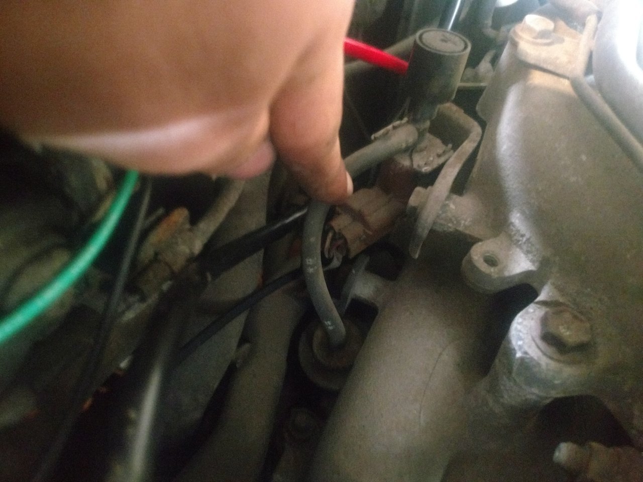

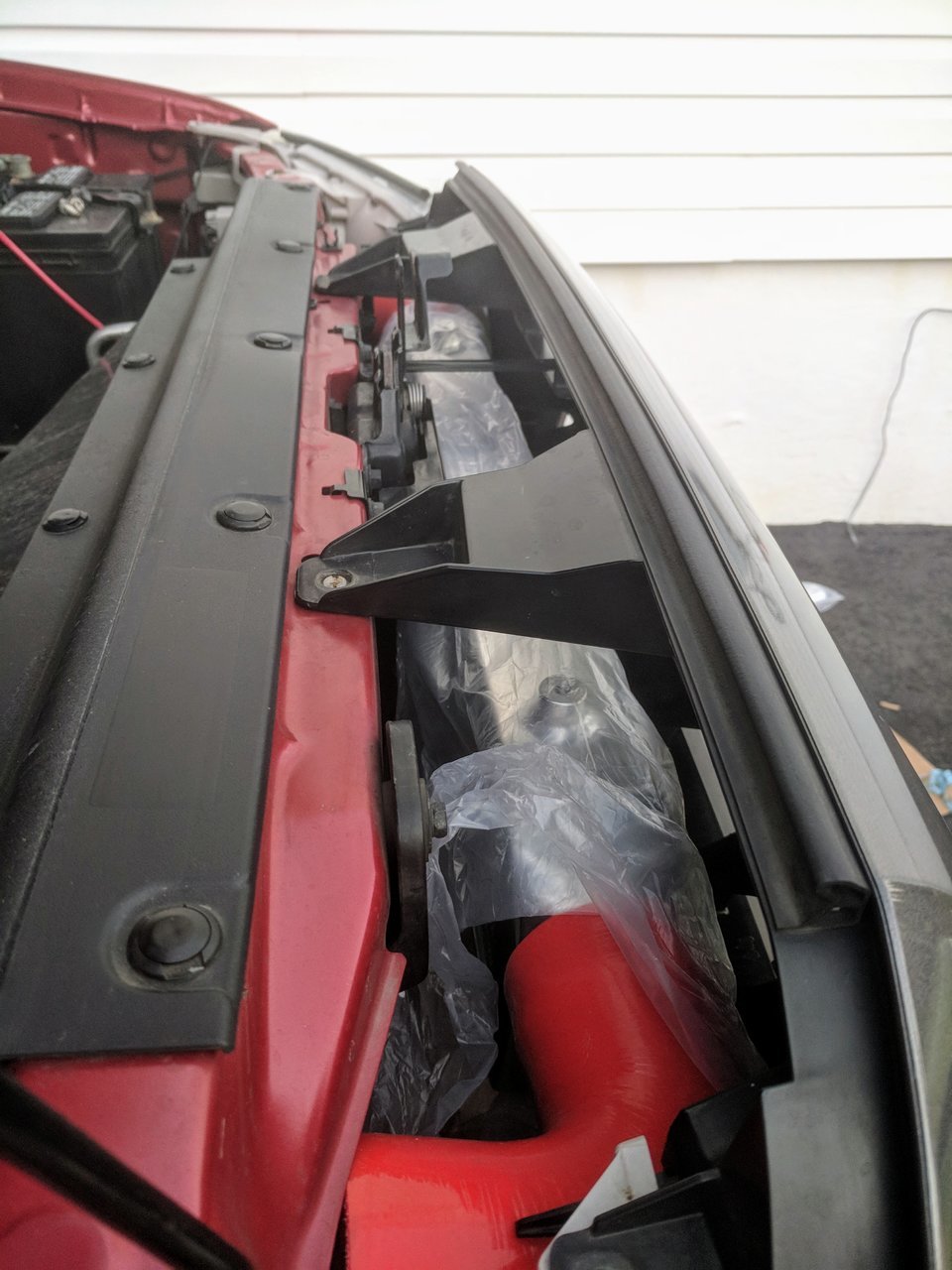

    is this the vac line i hook up to a boost reference for the fpr?

    That doesn't look like a good source since it is between the FPR and some sensor or switch.

    thats the vent for the fpr. it tees off on that vsv. its just vented to free air now as far as i can see through the vsv filter

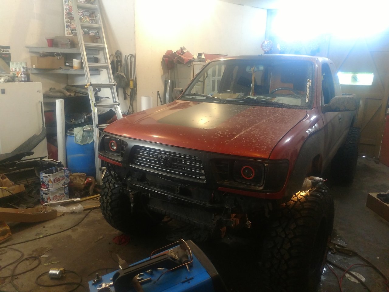

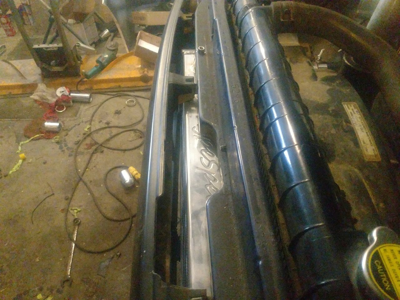

    i believe you wanted to see the finished product of intercooler behind the 95-97 grill @Blackdawg

    Sick. Nice work man! Exactly how i had envisoned it. Do you have AC? I had almost though you'd have to cut the center grill out and just use the intercooler to get a "satashoi" look.

    no ac. il take some better pics for you in a bit.

    theres about 2" of room behind it.

    I agree. That is a very clean installation .

    nice! looks great!

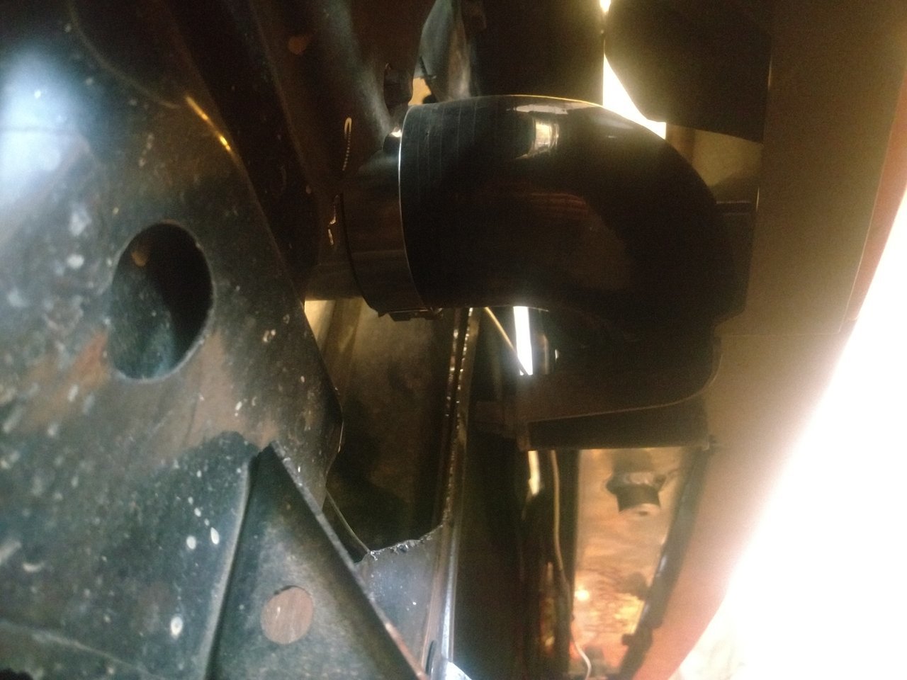

    im using same size intercooler and it fits like it was made for the grill. literally millimeters of gap all around and it sits tight at the sides. also 98+ dont really have the space between headlight and radiator to route the piping straight through the rad support.
