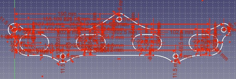

    so you would just need the 2TR header flange, not the plenum flange correct?

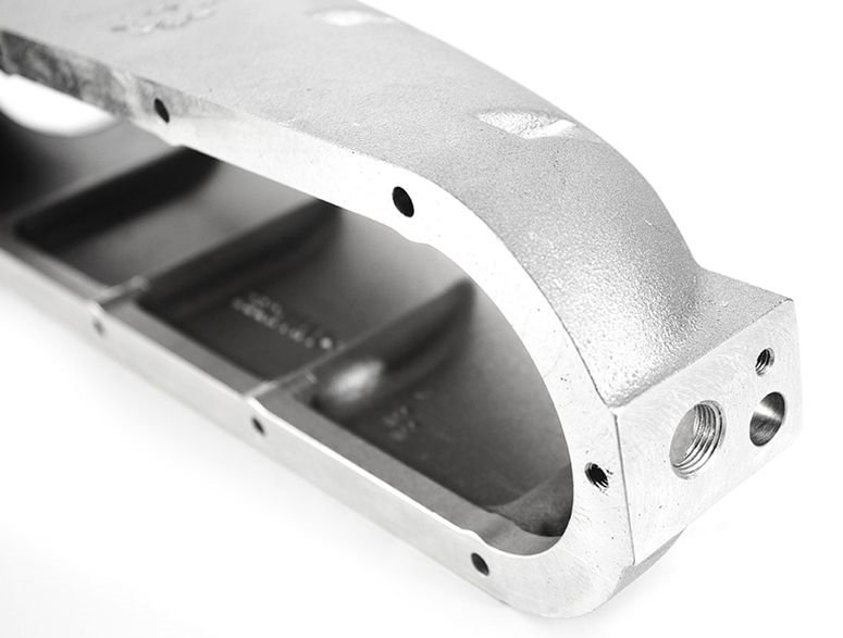

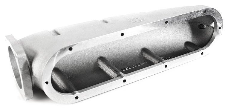

    I might be depending on final cost. What throttle body would that take? Also, how would that plenum seal to the intake runners? Are you thinking of an o-ring seal or just planning on RTV or a gasket?
    He has the 3RZ, so his flange at the head is different.

    I need the 3rz intake flange

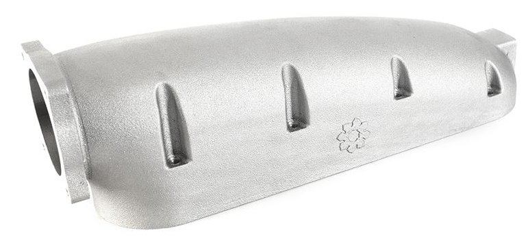

    It does have 60mm and 80mm throttle body option

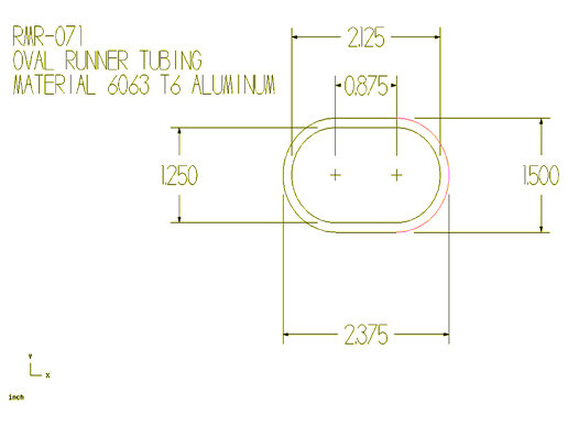

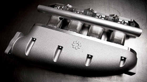

    Will look similar to this, but with longer runners swept forward to clear.

    Throttle body size won't matter if you can't controller it. There are 76mm Toyota throttle bodies that the stock ecu can control.

    I stated to show it matches our 60mm or gives option to make an adapter plate for larger bodies.

    that needs to happen for the 5vz so badly.
