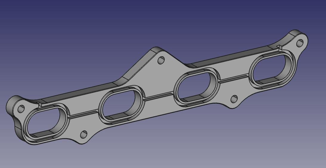

    I shot off a few emails requesting quotes.
