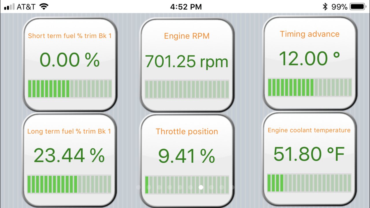

    Welcome to the wonderful world of tuning :annoyed: anyway does anyone know why the LTFT would be high idling it’s 24% and i moves around while driving but the STFT stays at zero mostly. Isn’t that the opposite of what it’s supposed to do ?

    If the ECU has trimmed the fuel table to what it likes with the LTFT, the STFT will be at zero. With a LTFT of 24%, the ECU is adding in 24% fuel over the base map, so you need to add fuel with your tuner at that load/RPM. The LTFT will then trend toward zero. LTFT changes aren't instantaneous, so I'd suggest adding 12-18% fuel at that load/RPM and see where the LTFT and STFT end up at. You can keep adjusting from there.

    Ok good it’s just the basic tuning thank you. After it’s running better I’ll let everyone know.

    Trying to tune your pinks is a good way to first get the hang of it. Once you feel comfortable you can throw in the 440s after.

    Also warm that coolant up first before tuning. Just realized that.

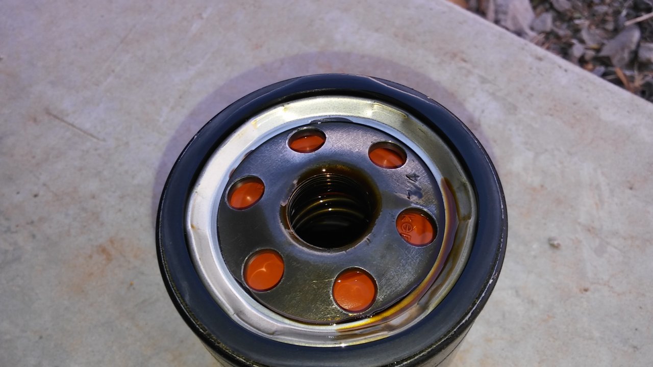

    On kind of a similar note, i changed my oil yesterday and when i unscrewed my filter there was no oil that drained out of it. Could it drain into my turbo feed line and thats why there wasnt any in it, or have i went several thousand miles bypassing my filter...
