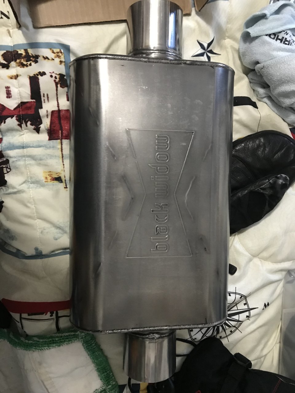

    Can’t wait to burn this in soon :)C0D782F3-01E7-4C88-97EF-A755E46166DA.jpg

    :bananadead: I gotta install all my other car parts first.
    What the specs on it? They sound clean on the v6 trucks. Haven't heard it on a 4 banger yet

    I haven’t heard them on an i4 yet either i got the venom 250 its alittle bigger than the race venom so hopefully it prevents the drone a little better while still allowing for a nice aggressive tone
