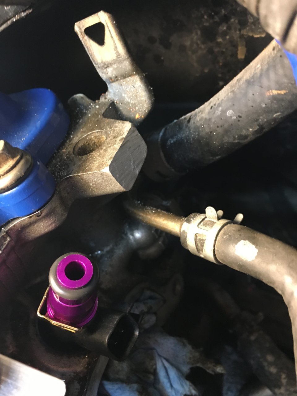

    Voided my warrenty to make the fuel rail fit ;) man it was scary taking a saw to it for the first 5 seconds lol. 60EEDD15-7792-4D97-BE45-8008D03FF970.jpg

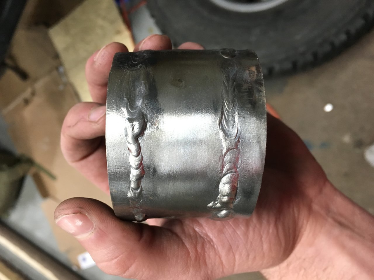

    Also practicing some stainless welding 672F68F2-6DDF-4AD2-B1EF-7595C383FD68.jpg

    16 gauge? What are your welding amps?

    Mar 16, 2017
    #213447
    3,280
    Jack
    North east
    3RZ 04 4x4 black ext cab
    2.5" lift king/total chaos Skids sliders rear tire swing
    I was just running 75 amps today think a little higher might do me good

    55 to 60 for the 16 gauge. Then get to moving. Only 75, if you are going to ease off the pedal back to the lower amperage.

    Oh okay I’ll gove that a whirl i was just going off the standard chart provided by Lincoln
