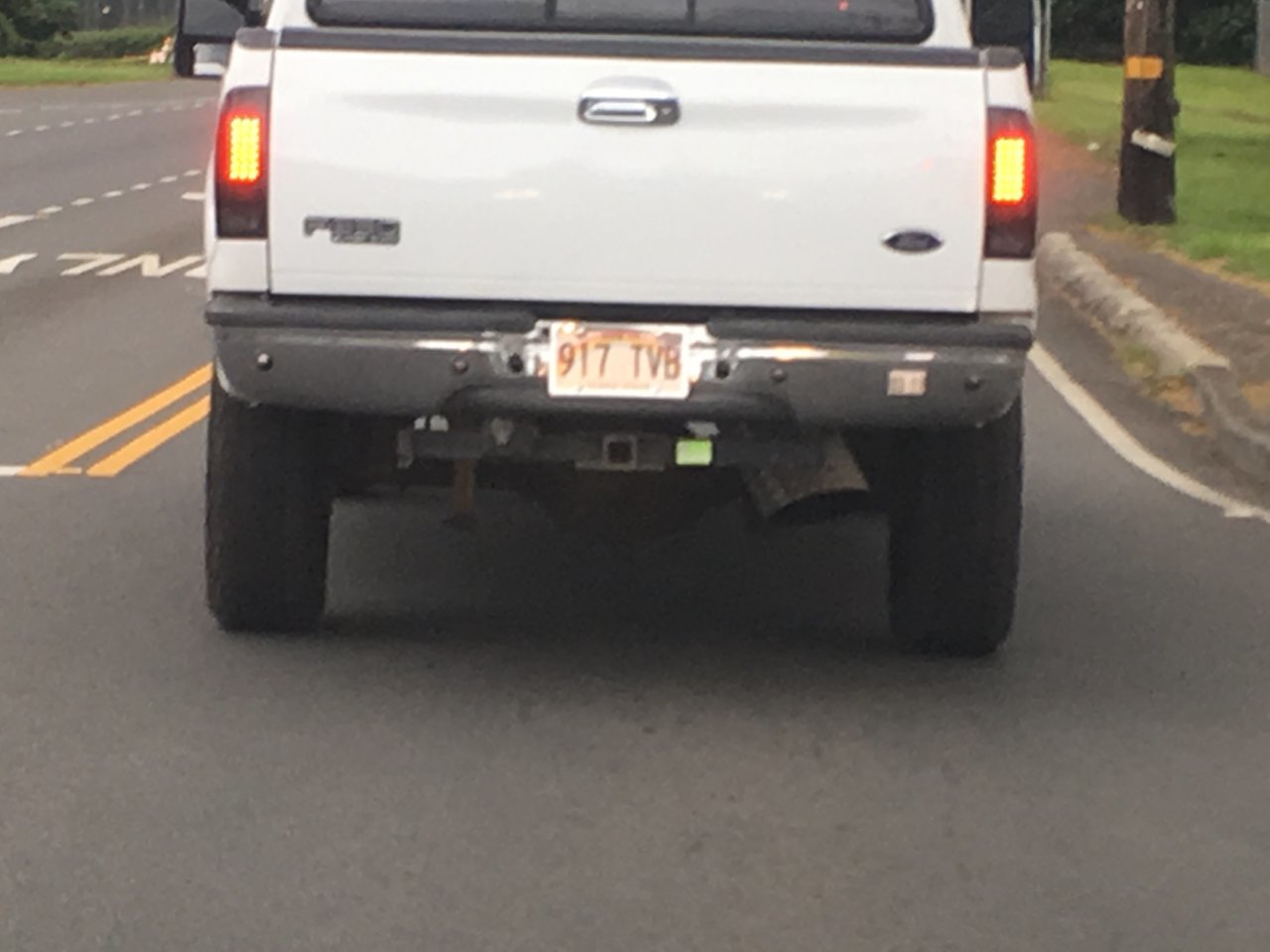

    Just took this. When you see it :rofl:

    Diesel rolling diamond plate :rofl:

    Dirt King Mid travel with King 2.5 coilovers, Baja Kits chase SUA with 14in fox smoothies under custom hangars.
    Oh Hawaii...
