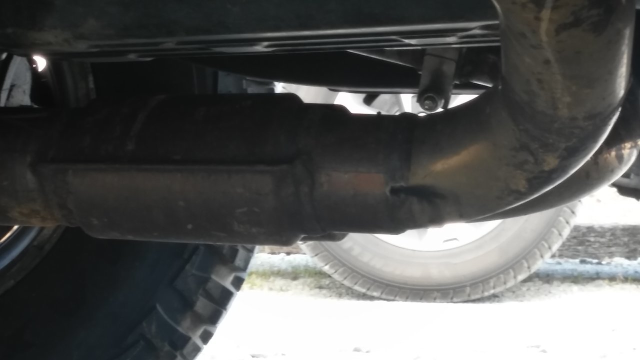

    I may have found a slight exhaust leak. When ever i get to work on it again im gonna take mist everything off and check all the welds again and maybe wrap some of it (and try and fix a galf dozen other things)

    I think i may have a hole where the clamp is on my down pipe; it touches the passenger side a lil before that goes into the y pipe because its freakin tight. But ill fix it and put some wrap on there for cushion haha

    Stiffer engine mounts will also prevent that flex which allows those tubes to hit. ;) Make some.

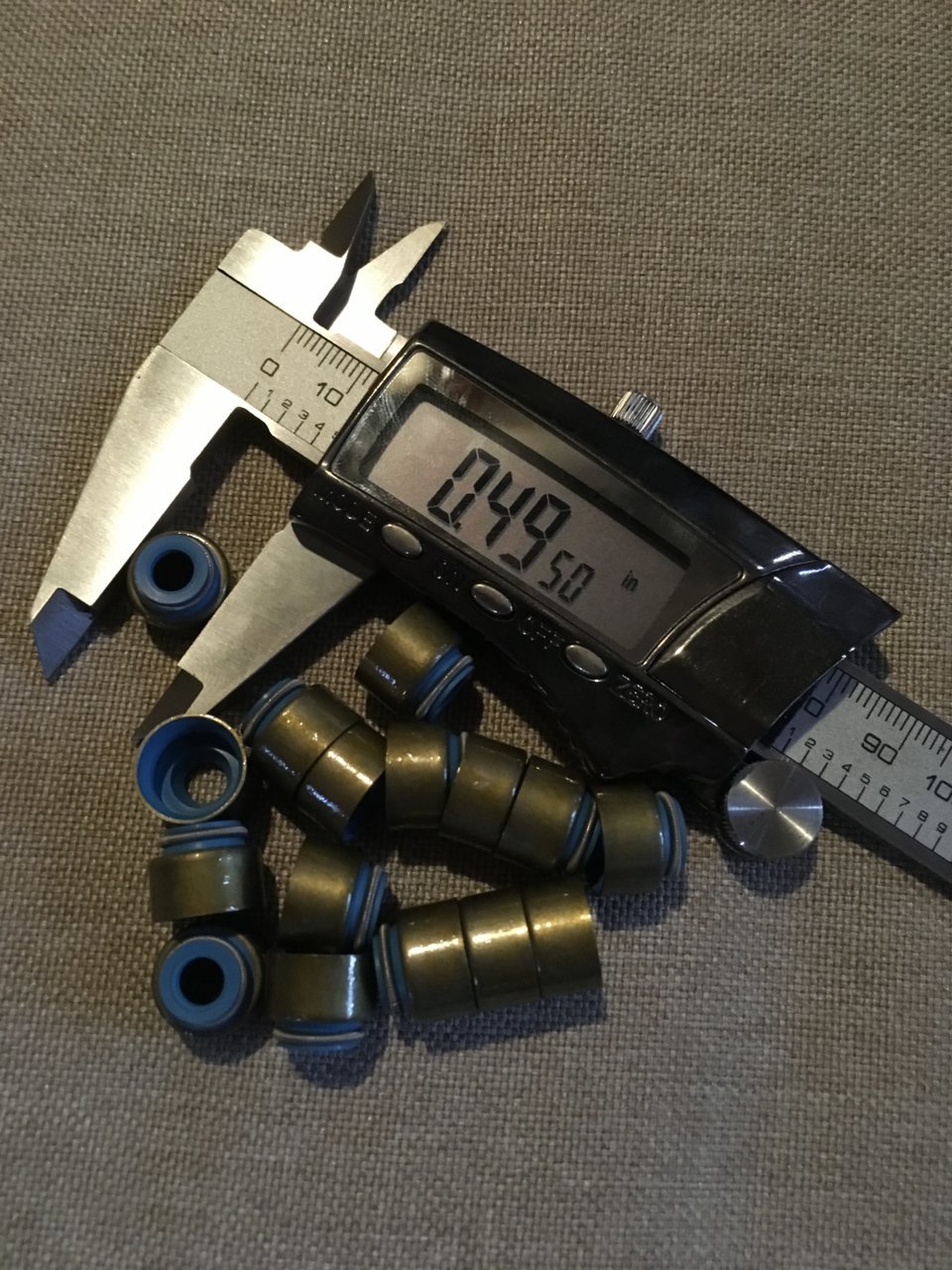

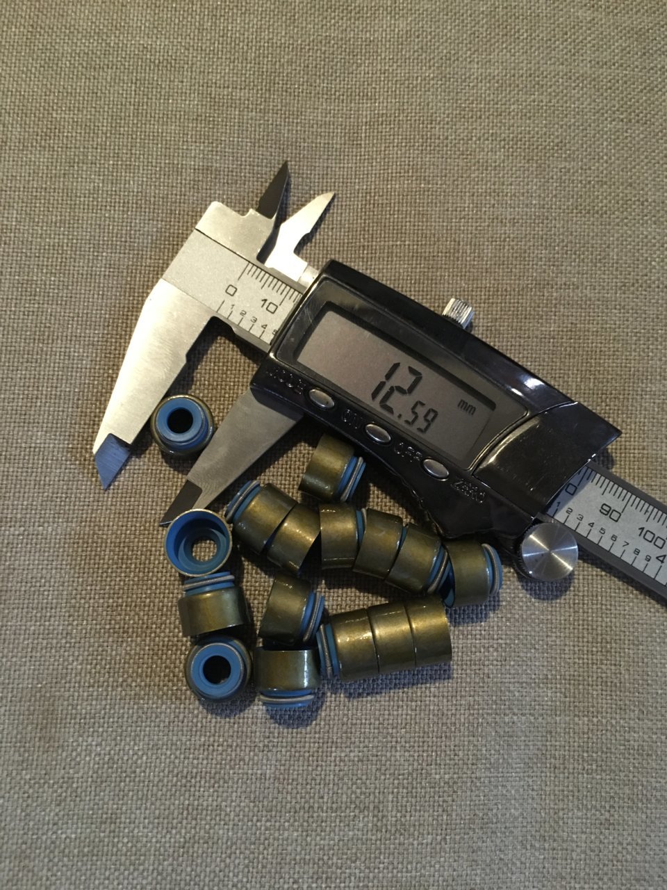

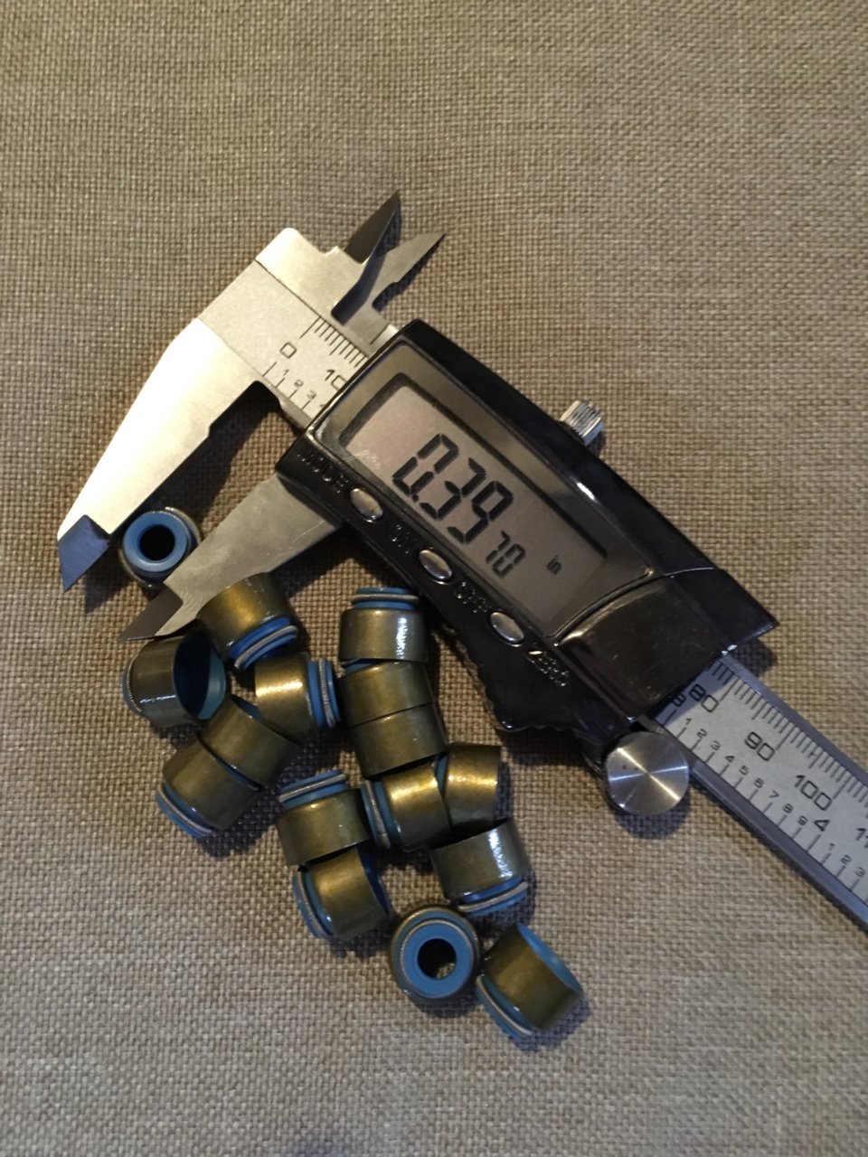

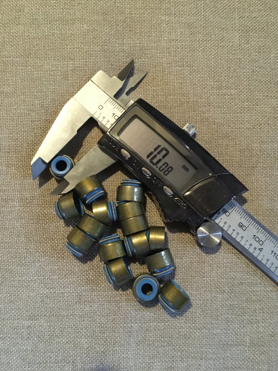

    Anyone know the OD on the Valve Stem Seals? I need to find an install tool.
    Also, does anyone know if the Toyota seals are Viton? And if so, on intake side too?
    Edit:
    I should specify 2TR-FE but it seems Toyota uses the same 5.5mm ID seals for dang near everything.
