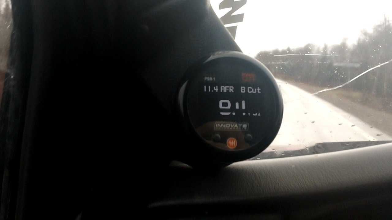

    stock injectors, 97 ecu, 75%meth. seems like a reasonable afr?

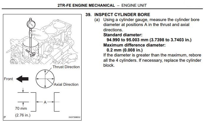

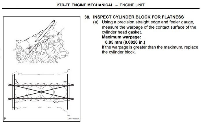

    From Toyota

    Solid to redline?

    That's what I had from my previous link and according to that I'm slightly out on cyl 2 and 4 but 4 had the best compression overall and is only out by like .0002 so I'm just gonna hone and call it good.
    Were I turboing I might recut just to be sure.

    I think I’m going to buy a bore gauge and straight edge

    th
    that was at redline.
