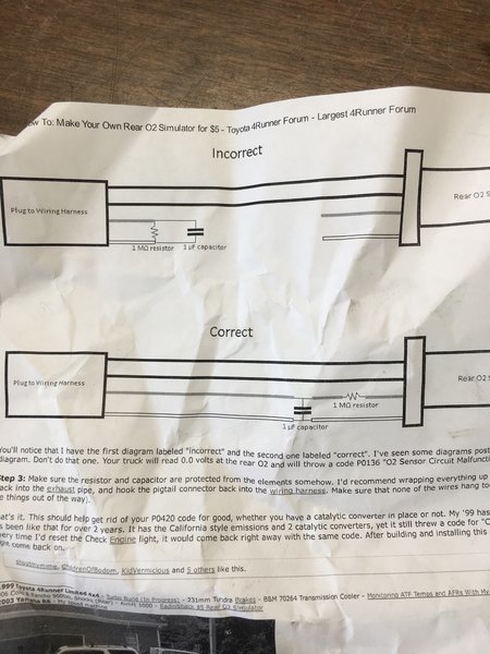

    Resistor needs to be in series. Means you cut the blue wire. Strip both ends. Solder to each end of the resistor.
    The way you have it the resistor isn't going to do anything.

    :facepalm::facepalm: I see that I just cut it in the middle

    Remove the resistor and solder it so one prong is on one side of the wire and one prong on the other. The two prongs on either side of the resistor should not touch.
    Make it look like this but if I were you, I would cut down the prongs to lessen the amount of exposed metal. Make sure to insulate with heat shrink.

    OK I fix the resistor and so far the check engine lights off thanks everybody
