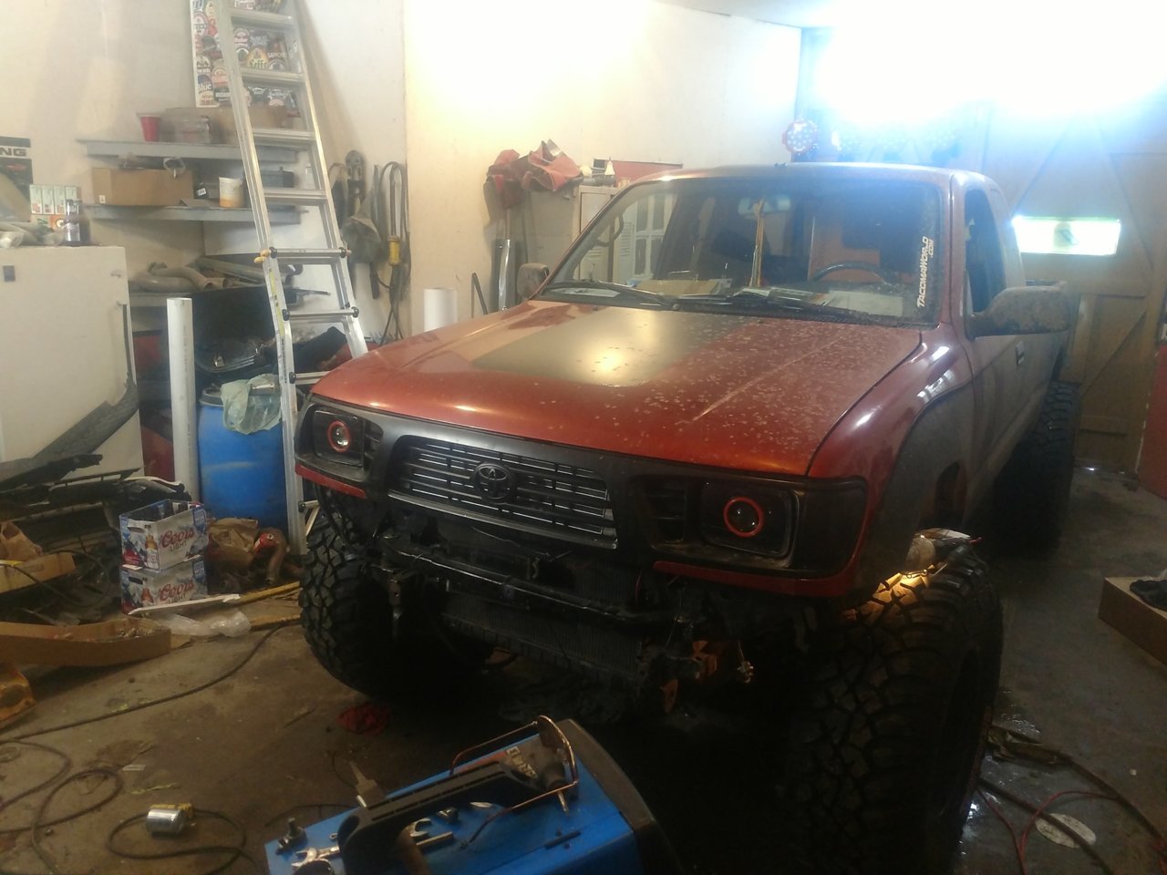

    First gen guys has anyone been successful mounting the IC up high above the bumper if so care to show me where you punched through the front? I’m not a fan of the low mount

    I've seen this.
    We also have someone on here with the 96 style grille did a larger one.

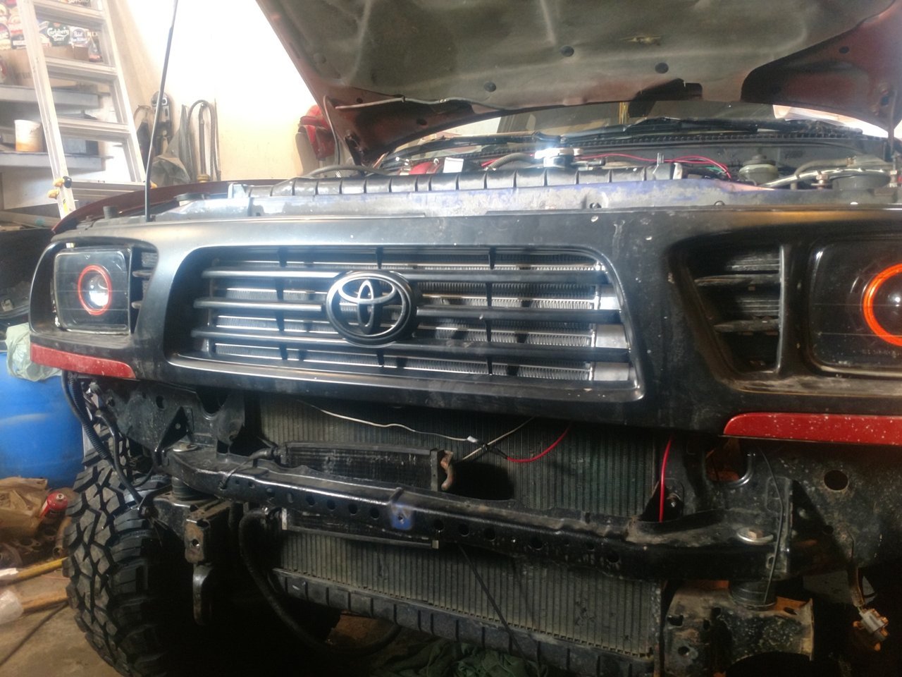

    I’m curious how he cut through the front to run it that high?
    With all the bends I can imagine a holesaw will have trouble

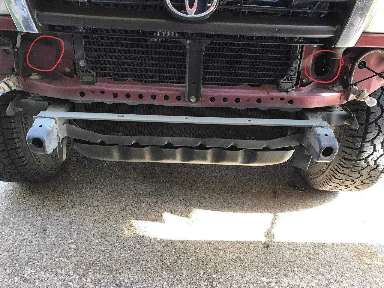

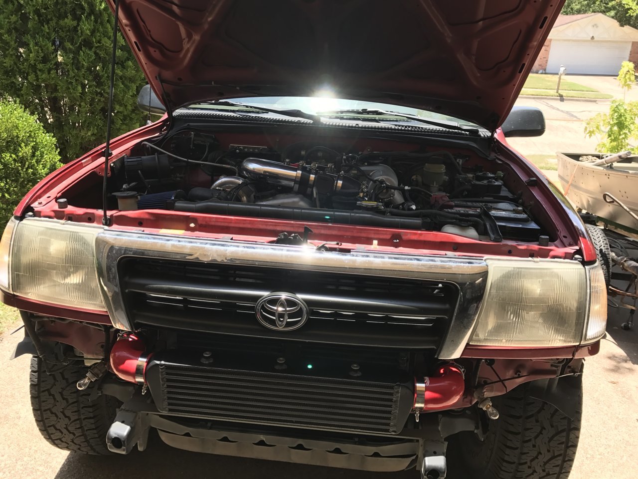

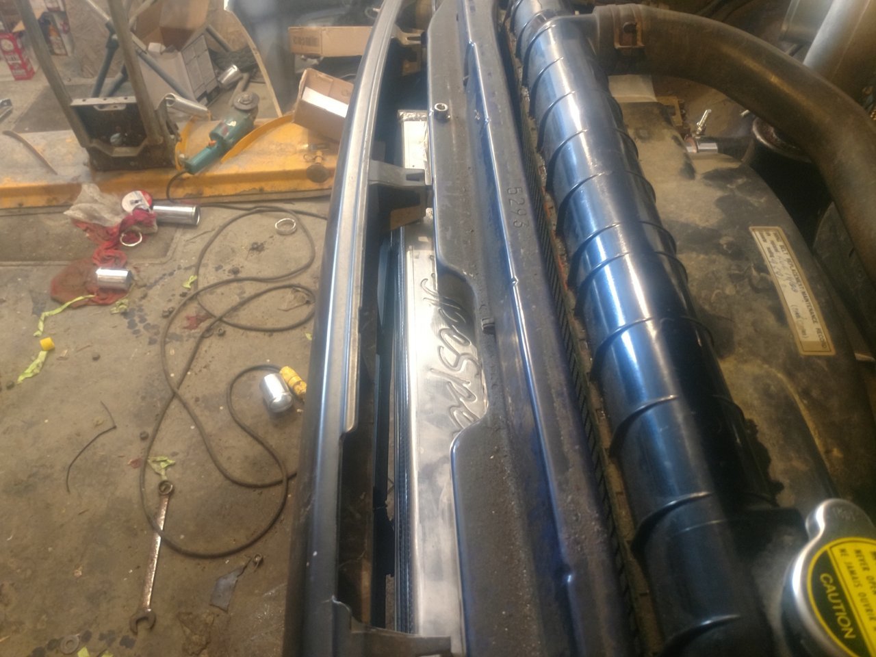

    I don’t know if this helps or if it’s considered high or low but at least you can see where to punch the holes without relocating linesF60B390F-ECAA-4C26-8631-68763230A915.jpg12AD5375-8A33-496A-A84C-EA0C5B317DD6.jpg

    What did you use to cut through
  10. May 12, 2018 at 8:41 AM
    #7410
    Jstand
    Jstand Well-Known Member
    Jan 24, 2017
    #208506
    1,125
    Jason
    Irving,Tx
    2011 Tacoma DC TRD SR5 4x4
    I used a reciprocating saw and nips

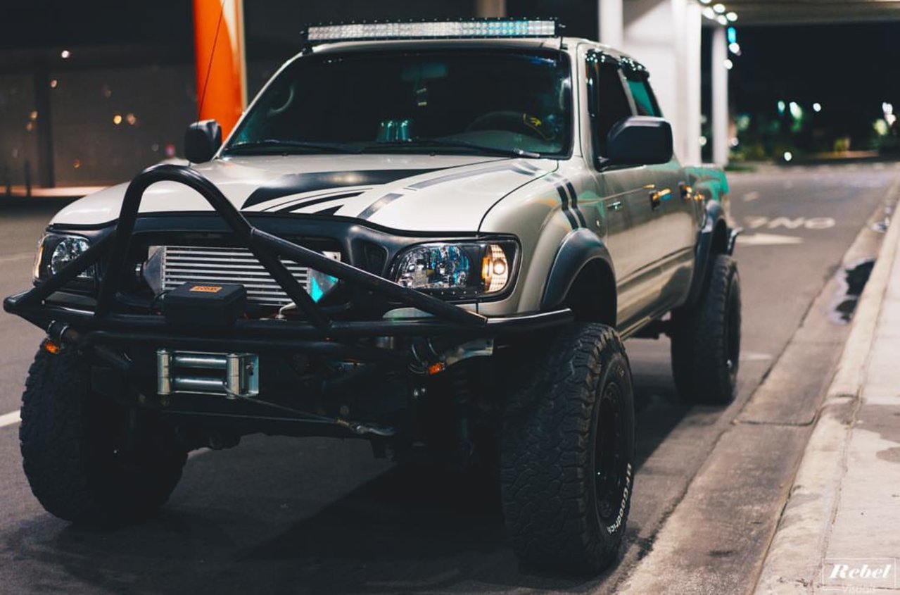

    mines directly mounted to the rad support (youl need hood pins to mount it high like this)
