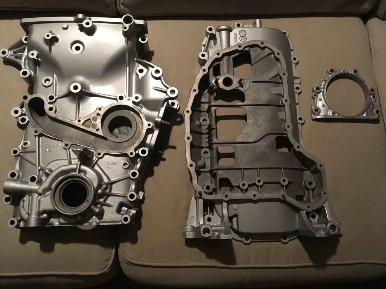

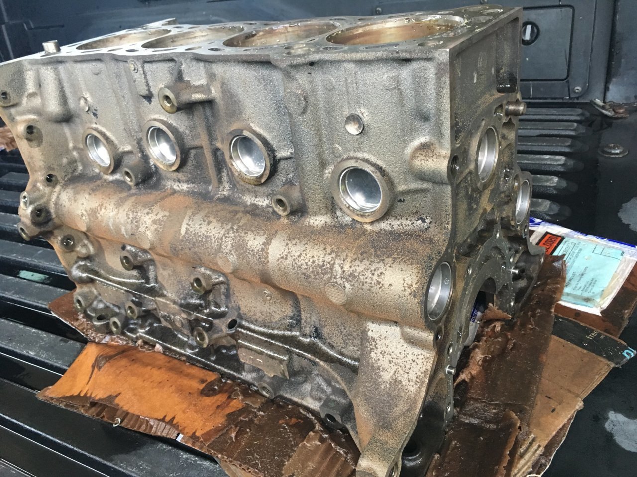

    Before/after hot tank
    Painted :turtleride:

    Wow. That turned out great!

    That looks great? What do you do with that nasty stuff when you're done?

    I have a water separator at work :thumbsup:

    For folks without, know that both Simple Green Pro HD and Lye are biodegradable. You could simply let the solutions rest until they separate and skim the top off and dispose properly.

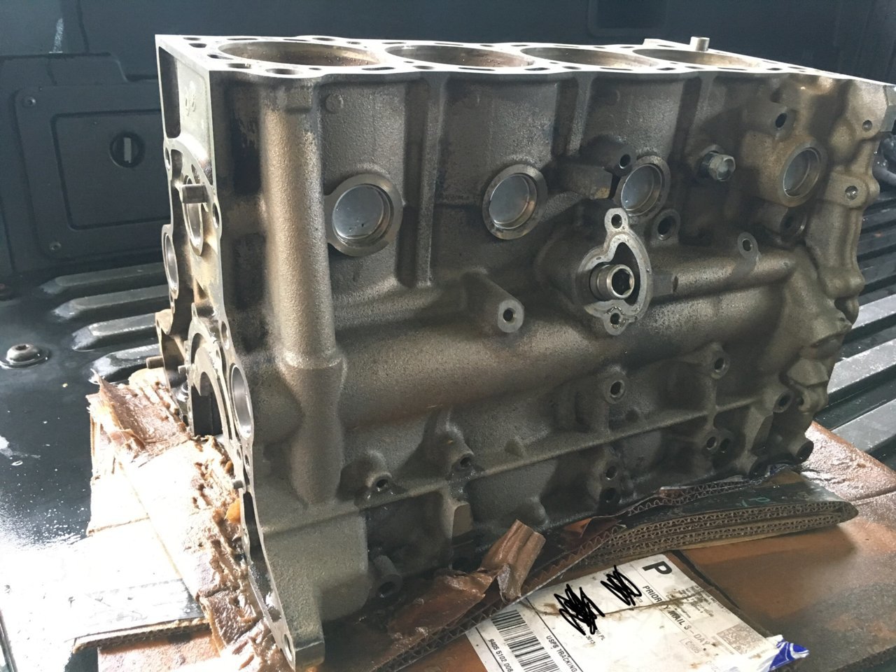

    A little pressure washer, cleaned right up. I checked the warpage again and it took a .0025 feeler so I’m afraid it’ll have to be surfaced too. I soaked it in Sea Foam penetrating oil after to store.

    You've done a great job, cleaning up that block. :thumbsup:

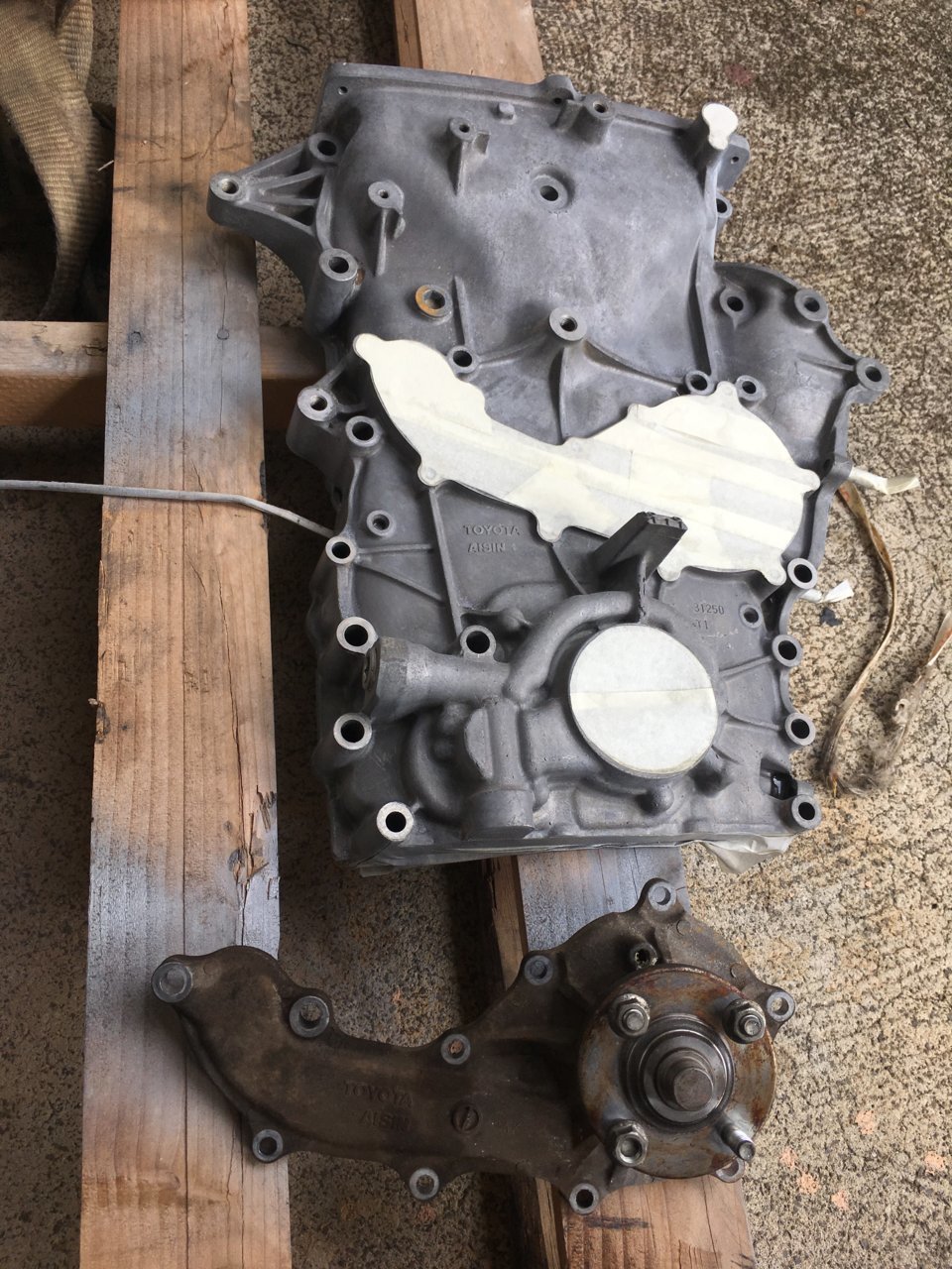

    The manual says to use seal packing on the block and head, I believe it's referring to the area between the points in this pic- I need some reassurance :anonymous:
    Edit:
    nvm it's clear as day now, I misread it
