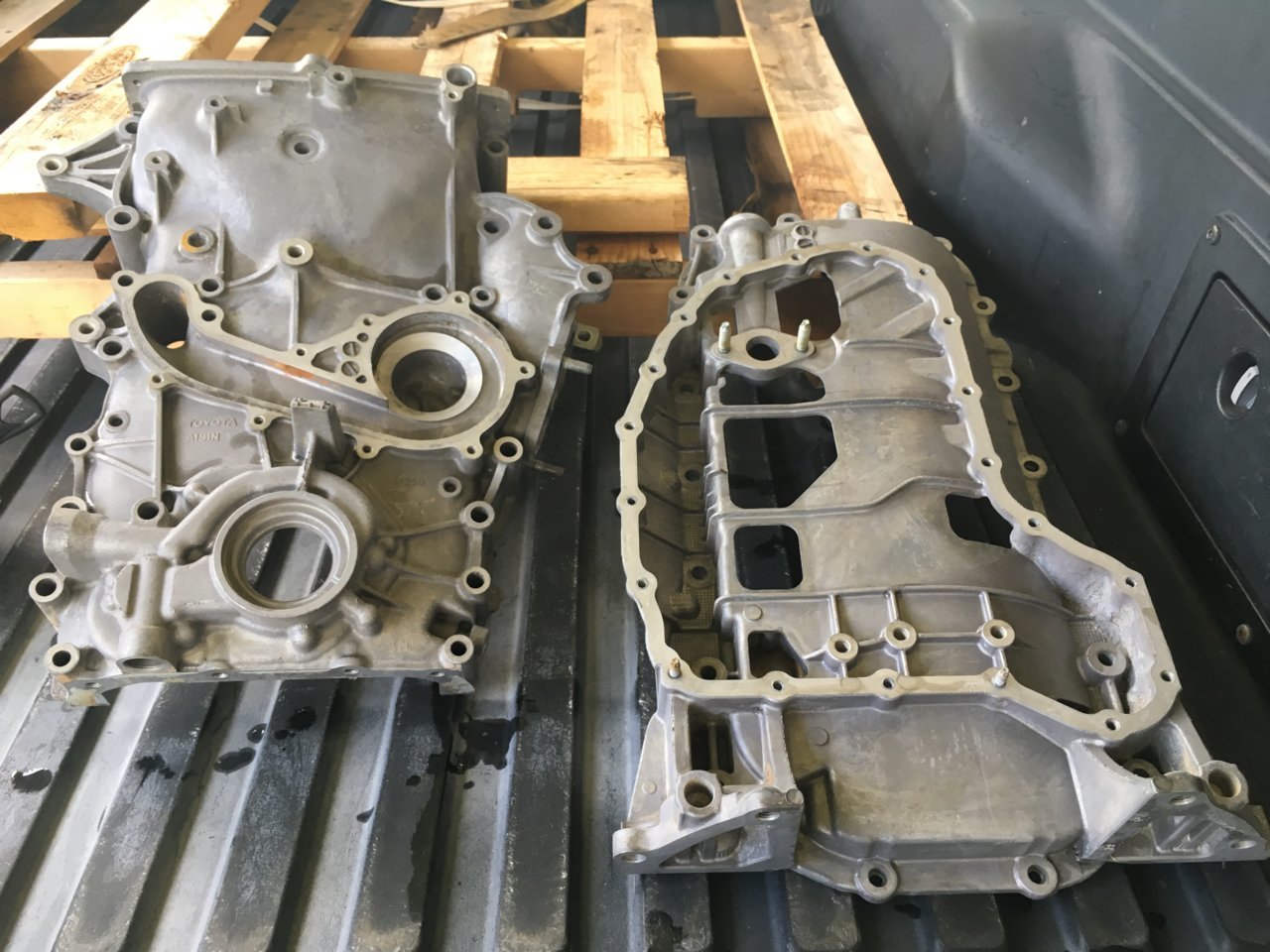

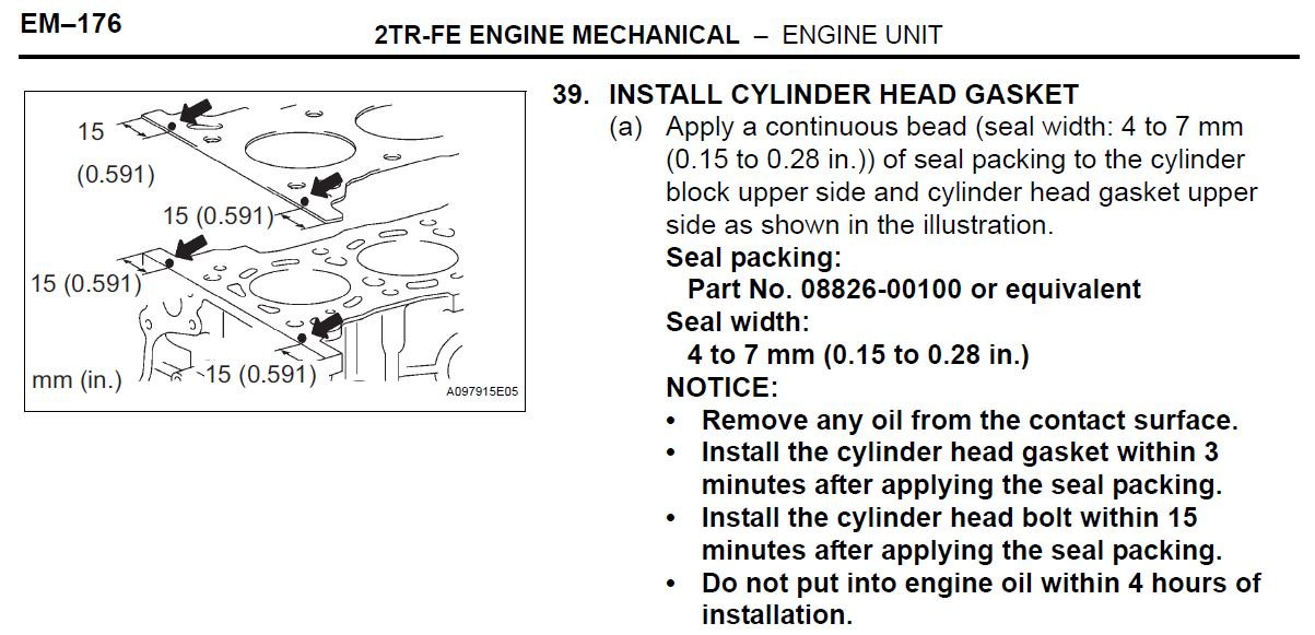

    The FIPG needed has an equivalent of THREEBOND TB 1282B... I can't find it
    Their website doesn't even list it
    http://www.threebond.com/product/series/sealants/s_a1200.html
    :help:
    Edit:
    It's in here
    https://www.threebond.co.jp/en/catalog/s_s11001200/index.html?pagecode=14
    Edit Edit:
    ThreeBond TB1207D looks like a decent substitute
    AISIN AB1207B1

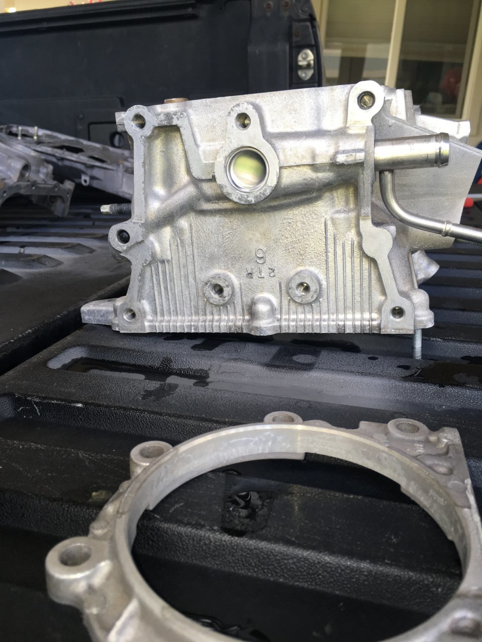

    What did you use as a straight edge?
  5. May 16, 2018 at 11:44 AM
    #7445
    05Taco4x4
    05Taco4x4 ToyotaHubs
    Jun 29, 2011
    #59085
    6,243
    2TR-FE Enthusiast
    FJ Tcase, Manual Hubs, 2017 Head unit, Mirror Riser
    Oh crap, I forgot... I got a machinist straight edge, 3-4" Mitutoyo micrometer and a SPI bore gauge - all .0001" like you recommended :thumbsup:

    Nice! Bummer about needing to recut it but at least you'll have a good surface moving forward.
    I'm going to try the simple green on my other aluminum parts. The acid got the majority of the carbon out of the head.

    @05Taco4x4 you had asked about the one in the DNJ kit. If looked at it since and it appears to be a comparable stock replacement.
    05Taco4x4 likes this.

    I was reading how Fel-Pro designed these with NASCAR and other racers. Apparently one of their initial releases was for boxer engines that had problems sealing up, seemed to be the fix. Also, the ford 4.6 give people problems because they want a crazy low RA and these seem too be the ticket too.

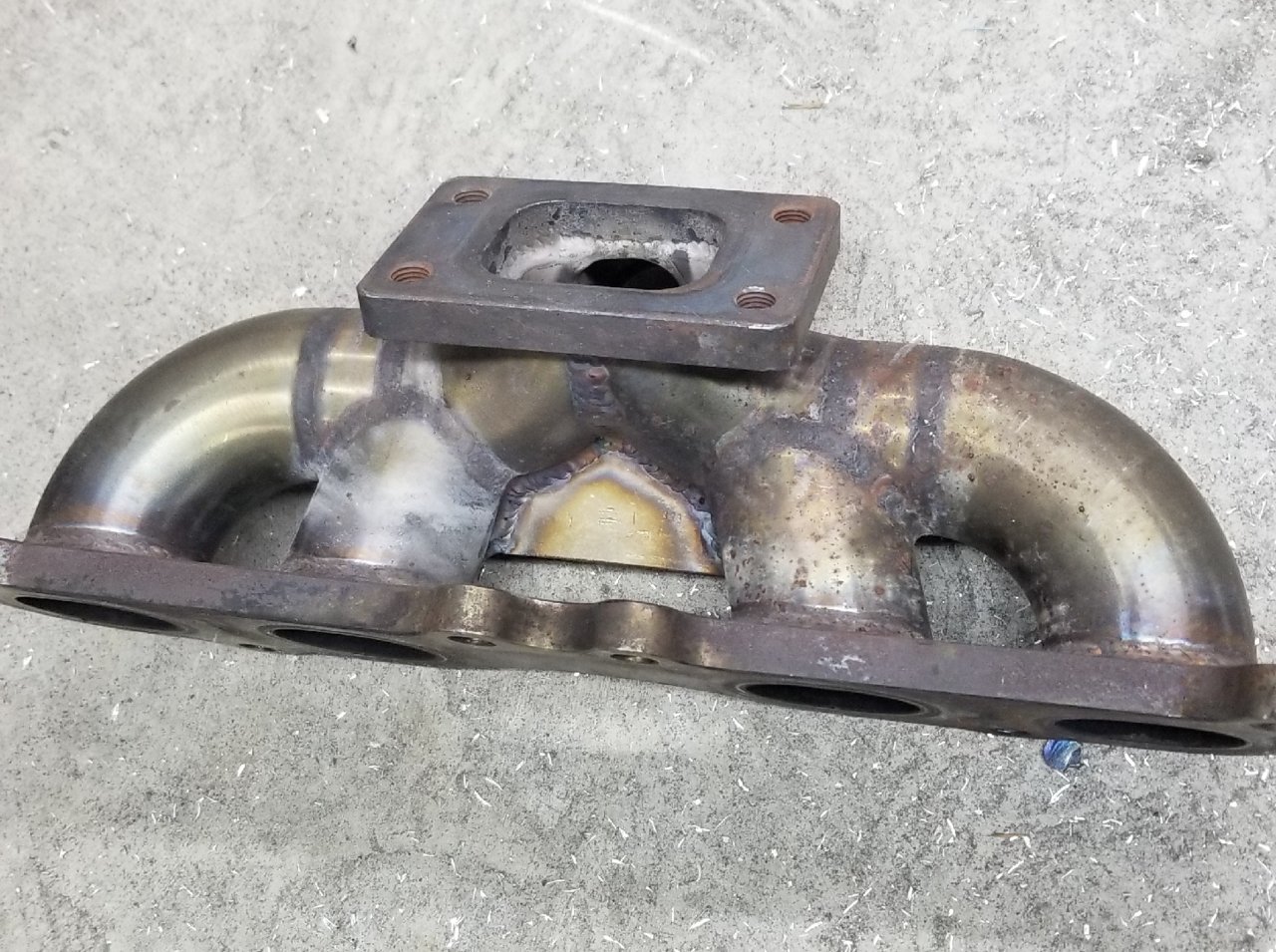

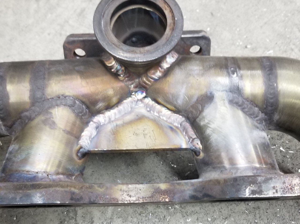

    So I sent my manifold to the guy who made it to repair it. It was delivered to him today at 2:00pm. He texted my at 3:30 with these pic and he’ll send it tomorrow. WOW !!!
    7C5B9812-B198-4693-A415-6DA4CF08E3AD.jpgThis is before. ^^^ 105D016A-D82A-40AD-848B-117B63587397.jpg1C57AFF9-7ABF-4FC3-879A-7A112EB42FE6.jpg
    RedLantern, 05Taco4x4, Torspd and 4 others like this.

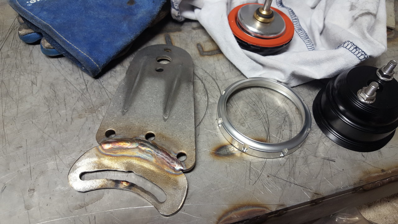

    What a chore it was to make this extension for the wastegate bracket.
