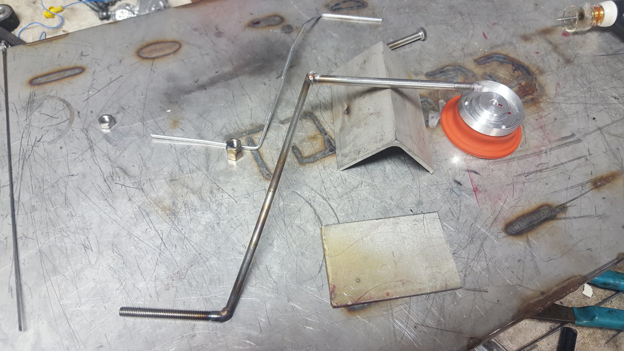

    Started with this:

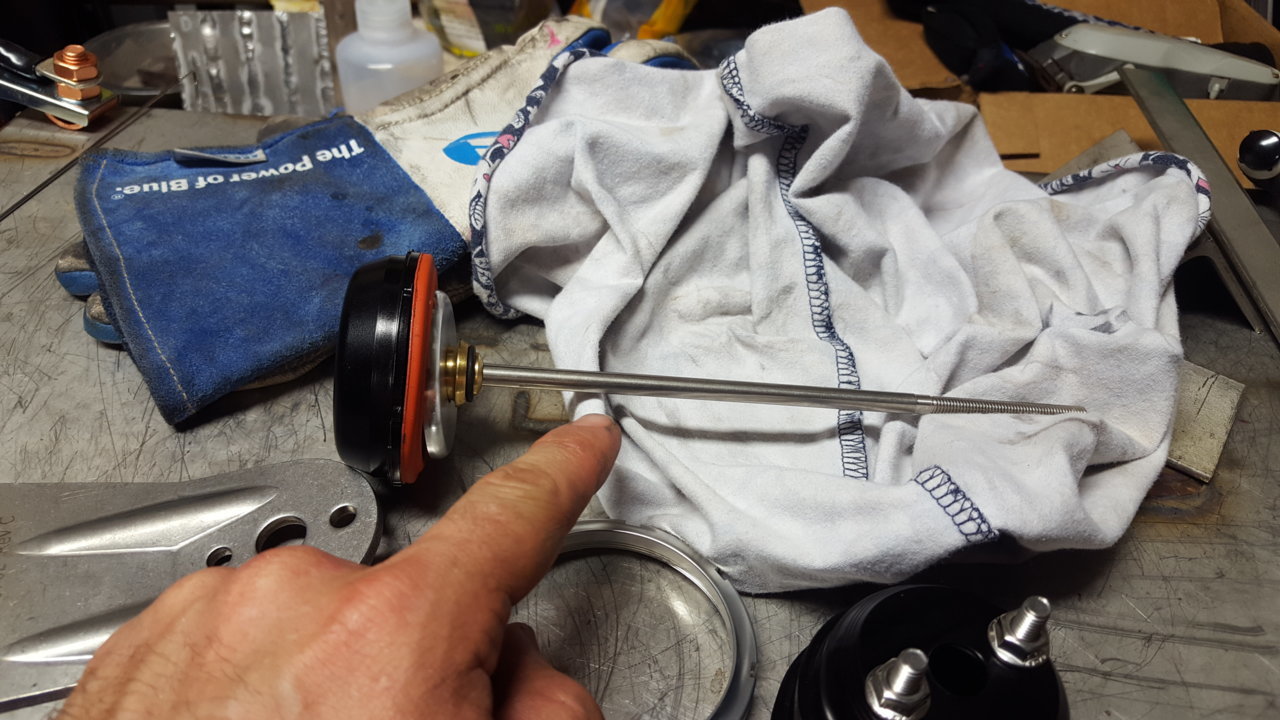

    Then finished with this.

    You think that much of a offset will work?

    Only one way to find out. I will pressure test it when it is light out. If need be, I will add a gusset to the top portion. Doubt it though, as that rod is tough.
    MrCrowntown likes this.

    The picture above doesn't capture the bends in the steel rod. The one in my build thread does though.
