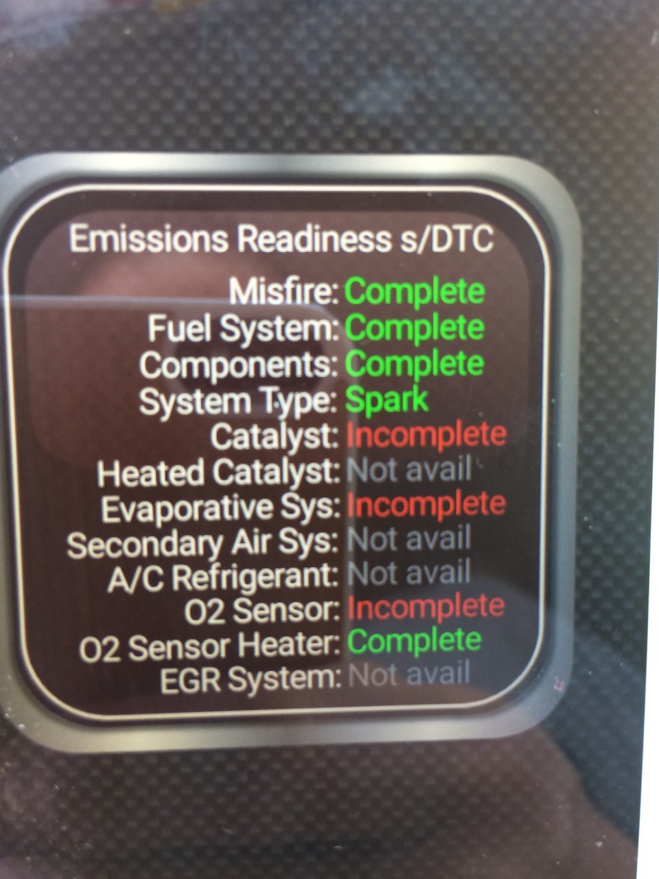

    What else do you think would cause so many things to not check in and be incomplete ?

    I thought of it when I saw @Jstand and was like, "huh it almost looks similar- let me do it" lol
    And Jason, as far as anything not checking in, I mean it could have to do with the AEM but it certainly shouldn't. You haven't reset a CEL recently have you?

    Unless you installed the AEM wrong it will not have any effect on any OBD 2 checks. Additionally, using the bypass could be more problematic if you've installed larger injectors or fuel pump. Also.. Dear god I wouldn't let emissions guys anywhere near my turbo'd truck if it wasn't tuned appropriately. They fucking 100% throttle it for like 3 minutes straight.
    Edit: If you're tuned only on boost you can try disconnecting your charge pipes. This will basically make the engine run as completely stock. The downside is your turbo is spooling at 100% so you're risking it's longevity.

    I did have to reset a CEL recently but the first time I went for inspection they said to drive for 50 miles so I did then came back and same thing. I disconnect the battery took out the Aem let it set for 10 min and drove 15 miles with no change so I’ll drive another 35 and see if it changes. On one of the apps I use for diagnostic it shows me if it’s ready for emissions test or not. That would have saved two trips. If there is no change as much as I hate to I’ll have to do the “$100 inspection” this time.

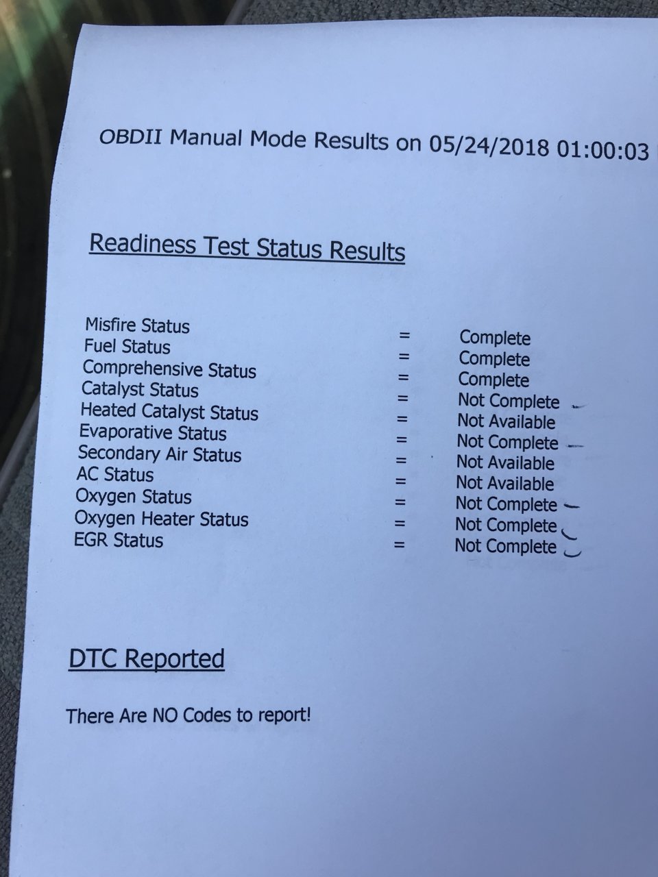

    I think your allowed two incomplete.

    This is what I do to get my truck to check in. I can usually get all sensors to check in under 20 minutes.

    The aem should not stop these from completing how many miles have you put on since you clear the codes? You need to put at least 100 miles for the checks to be completed
