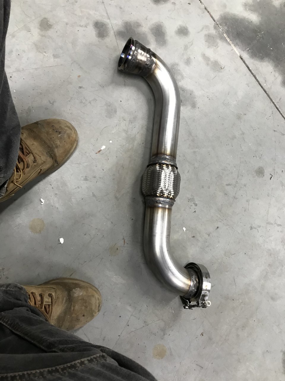

    Woo down pipe welded and exhaust to the muffler installed just need to burn in some bungs then just my haltech is left to doo!!!F1A9A40E-1427-43DE-B62A-476A8F3189DB.jpg70BE3EF3-F287-488B-9D7B-D120D40BE287.jpg

    Nice how did you convert the housing to v band?

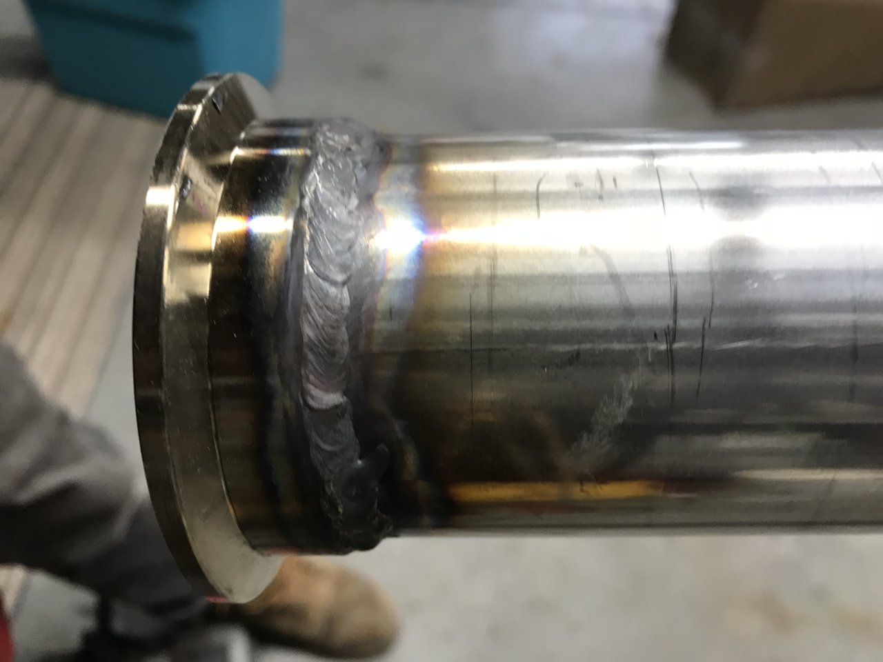

    My housing is vband

    If I may, which size cup are you using, and what CFH are you flowing?
  13. Jun 15, 2018 at 5:43 PM
    #7753
    Jcyr
    Jcyr Midnightthetaco
    Mar 16, 2017
    #213447
    3,280
    Jack
    North east
    3RZ 04 4x4 black ext cab
    2.5" lift king/total chaos Skids sliders rear tire swing
    A #8 and 25cfm why whats up

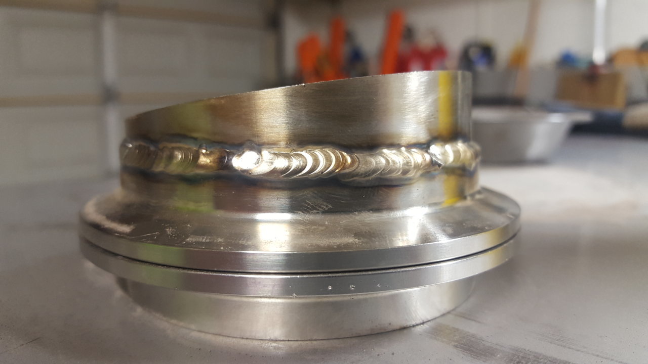

    Torspd Custom Turbo kit [] Borg Warner 9180EFR Turbo [] Haltech Elite 2500 [] TiAL Q BOV [] TiAL V44 Wastegate @ 15psi [] CP Pistons [] CP Carrillo Rods [] ARP Head studs [] ARP Main Studs [] ARP Header - Head Studs [] Ported Heads w/ 1mm oversized valves intake/exhaust [] Brian Crower Forged Stroker Crank [] Darton M.I.D. Sleeved Block [] Kelford Camshafts [] Torspd 160* T-stat mod [] APR Large Fuel Rail [] Walbro 460 LPH E85 Fuel Pump [] FueLab FPR [] APR T56 Conversion Kit [] KP RACING Built T56 [] McLeod Racing Custom Twin Disk Clutch [] One Piece Aluminum Driveshaft [] MGW Shifter [] Custom lowering kit [] Ohlins Front Coilovers [] QA1rear shocks [] Custom Ron Davis Radiator [] Dual SPAL Electric Fans []
    The dark nature of the weld puddle. I too had the same puddles. Realized through a few videos from The Fabrication Series, and Welding Tips and Trick, on YouTube, that my gas coverage was too insufficient. Separately, my technique also needed improvement, but that is my own, and not yours.
    Your CFH is spot on. Now, heat affected zone aside, with a #8 cup, you have to stay very close to the puddle. Very steady hand, so that the gas coverage keeps out the elements. With a larger cup, it is much more forgiving and much easier to have a "white" puddle after a weld. "White" being considered the best.
    Just a polite criticism. If you have a larger ceramic cup, try it. You'll see an immediate difference. For the record, I use a #12 cup when welding the stainless. My welds aren't 'Weldporn' uniform, but they have improved to very little color.
    Jcyr likes this.
    This picture will show all of my faults and novice skills simultaneously. While illustrating the color that I spoke of.
    Jcyr likes this.
    Also take note of the H.A.Z.(Heat Affected Zone, around the weld) on my weld, compared to yours. This was done at 74 amps, 16 gauge 304, but most importantly, moving quickly. Doing 5 - 10 dabs at a time.
    Jcyr likes this.

    Looks good man.
    Today was my first day ever really welding pipe just happy its all sealed lol
