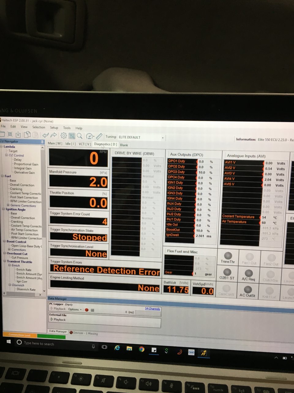

    Well it cranked but couldn’t get it to start tonight

    I think my ignition or injectors are the issue currently. Still trying to learn what everything means D5E4BC13-9B67-4861-955D-9BEC9E47B53C.jpg

    He is working out some OBD codes, but if he gets them to go away then he should be good.

    Did you figure out the issue and get it started yet?
    The reference detection is the cause. Hypothesizing, I believe you may have your crank trigger setup for reading the wrong direction of rotation. Do you understand what I mean by that?

    How would I fix that??
