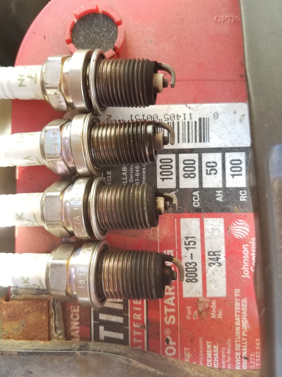

    I blew a hole in one my my boots twice this week the second time having to limp it further to my parents house to replace it. When that happened I was running really rich because not all of the metered air was entering the combustion chamber. Got that all fixed up now I'm constantly in limp mode via knock sensor code p0325. Did some research my wires look good....could I have really have had a sensor just cramp out like that? Is there a chance my spark plugs are fouled and that's what's throwing the code?that doesn't really make total sense I've just never had a knock sensor shit the bed

    Check the plugs. It's free. Then we'll go down the line.

    Left to right starting at the front

    That bottom plug was rich for certain.

    Yeah switched the plugs to the ones I was using before I did head gasket. Didnt make a difference.

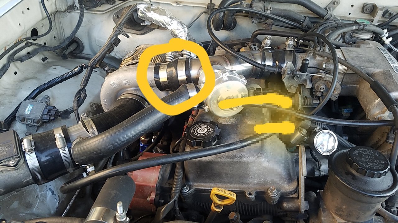

    Old photo and different turbo but I'm talking about this boot. Sorry if my wording was off in the last post. Have a haltech 550 but not hooked up and no tune so just stock ecu right now. Keeping it under 10psi

    Torspd Custom Turbo kit [] Borg Warner 9180EFR Turbo [] Haltech Elite 2500 [] TiAL Q BOV [] TiAL V44 Wastegate @ 15psi [] CP Pistons [] CP Carrillo Rods [] ARP Head studs [] ARP Main Studs [] ARP Header - Head Studs [] Ported Heads w/ 1mm oversized valves intake/exhaust [] Brian Crower Forged Stroker Crank [] Darton M.I.D. Sleeved Block [] Kelford Camshafts [] Torspd 160* T-stat mod [] APR Large Fuel Rail [] Walbro 460 LPH E85 Fuel Pump [] FueLab FPR [] APR T56 Conversion Kit [] KP RACING Built T56 [] McLeod Racing Custom Twin Disk Clutch [] One Piece Aluminum Driveshaft [] MGW Shifter [] Custom lowering kit [] Ohlins Front Coilovers [] QA1rear shocks [] Custom Ron Davis Radiator [] Dual SPAL Electric Fans []
    Basically when you blew that silicone coupling, you had a massive vacuum leak. Since it is post MAF sensor.
    Simple enough. You have a new coupling on, and have cleared the codes repeatedly. Intermittently it returns, even without the vacuum leak. Is there a specific driving condition that which causes it to activate?
    I am leaning towards a knock sensor malfunction alone.
    I imagine that you have at some point also upgraded your fuel pump, yes?
    There looks to be an off center alignment with the coupling. Not sure which brand couplings you are using, but another brand might do the trick.

    Yep upgraded aem pump. Actually I'm using another turbo,same I Intake pipe. The turbo outlet is bigger so I'm not using that coupling and the one I did use was cheap and I'm thinking the heat is what cause that to slip off and then just blow holes. Nope once I get the code and then clear it it comes on immediately. I'm really only able to be in 2nd or 3rd gear probably around 2300-3100 rpm haven't gonna over 45mph
