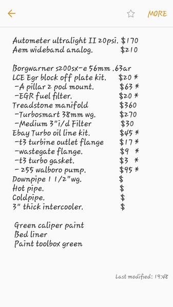

    Eh, I wouldn't go serious...for now atleast. Going Screenshot_20170320-194848.jpg Screenshot_20170320-194848.jpg
    Afterwards, megasquirt3 and when I'm ready forged internals

    good man on the mega squirt3. Doing right.
    Gonna totally suck to wire up but worth it in the end.

    Always a fun project:rofl:
    Not wanting to go cheaper or easier, doing it right the first time

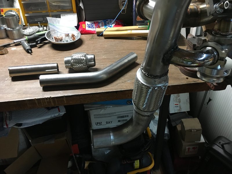

    IMG_5458.jpg I would really appreciate opinions on the best way to redo the wastegate dump tube. I have the 90 on the downpipe, flex pipe, 45 and some straight

    Uh:frusty: I'm too cheap

    Ebay helps to keep it in the medium, and Treadstone turbo parts
