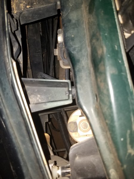

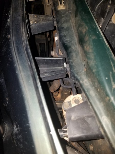

    I have a plate bumper and a winch, no way in hell is it fitting down there
    For the IC pipes, theres not a single hole big enough to fit them
    A/c dryer
    I hope not...unless its tmic

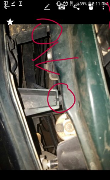

    Run bolts thru here and add as much spacer as you need to make the whole big enough to fit the ic and either dont worry about the gap on the sides or get some garden edger and ricer trim it outCapture+_2017-05-02-20-13-01.jpg maxresdefault.jpg

    I cut holes for mine. Take your bumper off and its not too hard. And that whole "measure twice cut once" shit...? Measure 50 times before you cut.
    Mount the IC first and make sure your bumper fits over it before measuring/cutting.
    I almost made an irreversible mistake but caught it as I had my grinder, running, in my hand.

    Are you talking putting it behind my bumper?

    There is an oval shaped hole on the drivers side just under the AC dryer. Open that hole up a little more, and cut one the same on the other side.
    Either way, to get pipes up front through the core support, you'll have to cut something.
    Top mount is probably not going to give you what you want. Tape a bunch of little strings on your hood and find out if there is even enough pressure over the hood to accommodate for a scoop

    That's how I did it. Behind the grill will work if you remove your AC lines. I couldn't find any other way to mount it.
