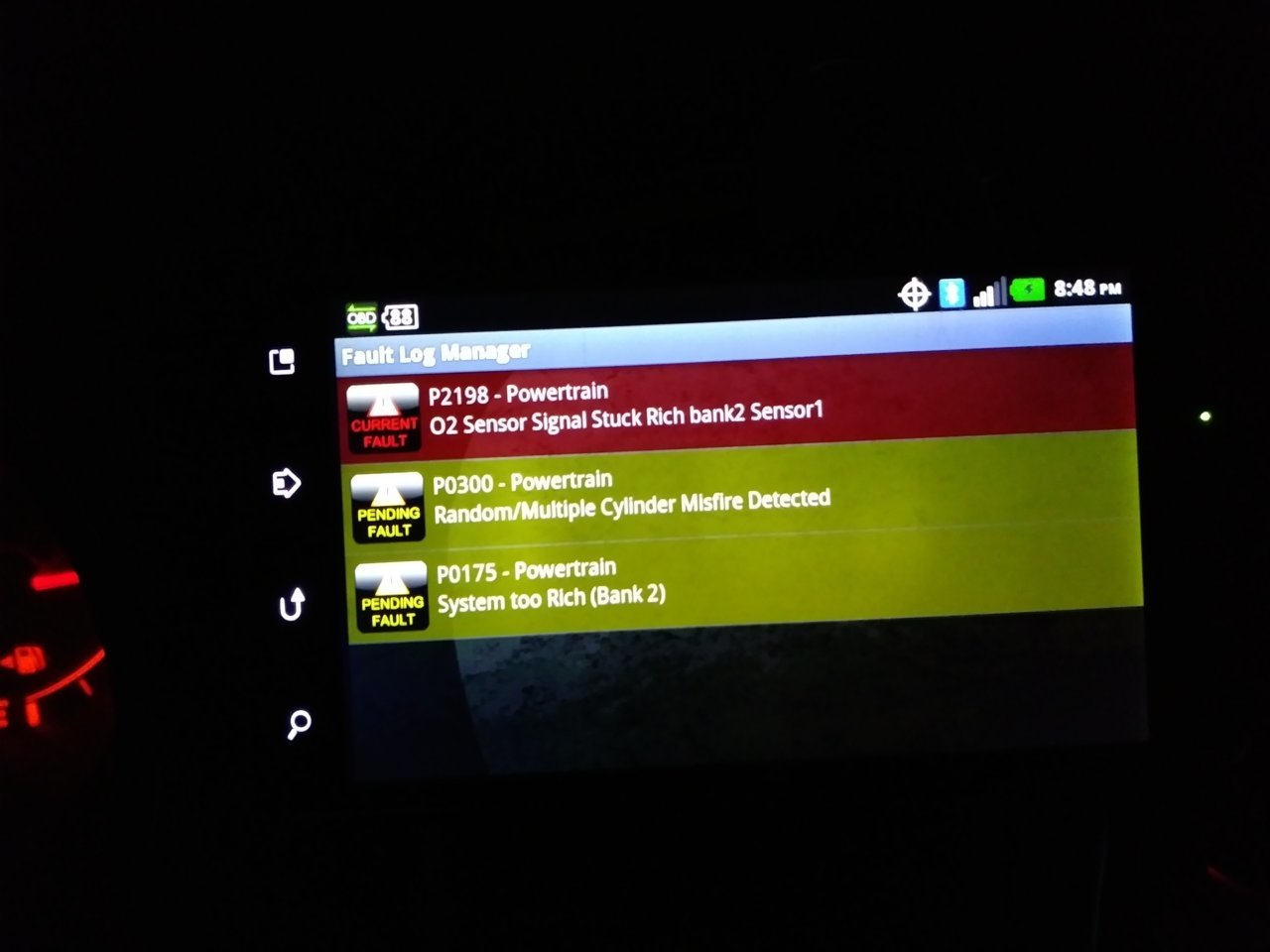

    Yeah I was thinking it would get me closer than I am now. But since I dint have an afr hooked to the mapecu3 it may end badly.
    I'm still getting a bank 2 sensor 1 stuck rich code. Could something else cause that?

    Are you running MAF intercept or MAF elimination mode? If you're MAF intercept then zeroing out the table puts you back to stock.
    Are you running stock injectors or bigger than stock? Maybe one is leaking or stuck open.

    Maf intercept and the 61# injectors from urd
    I had a halfway decent tune but then it started throwing that o2 sensor code and I thought I was just tuned too rich so I messed with it some and could t get it to fix so I replaced the o2 sensor and the code came back within a couple miles so I tried redoing the tune last night and cleared the code and now its terrible

    Do you have the tune file of when it ran well?
    If so, the try reloading the MAPECU software. Been dealing with this recently on my friend's 2TR s/c truck.
    Reloaded the software, then loaded the good map back in. Problem solved.

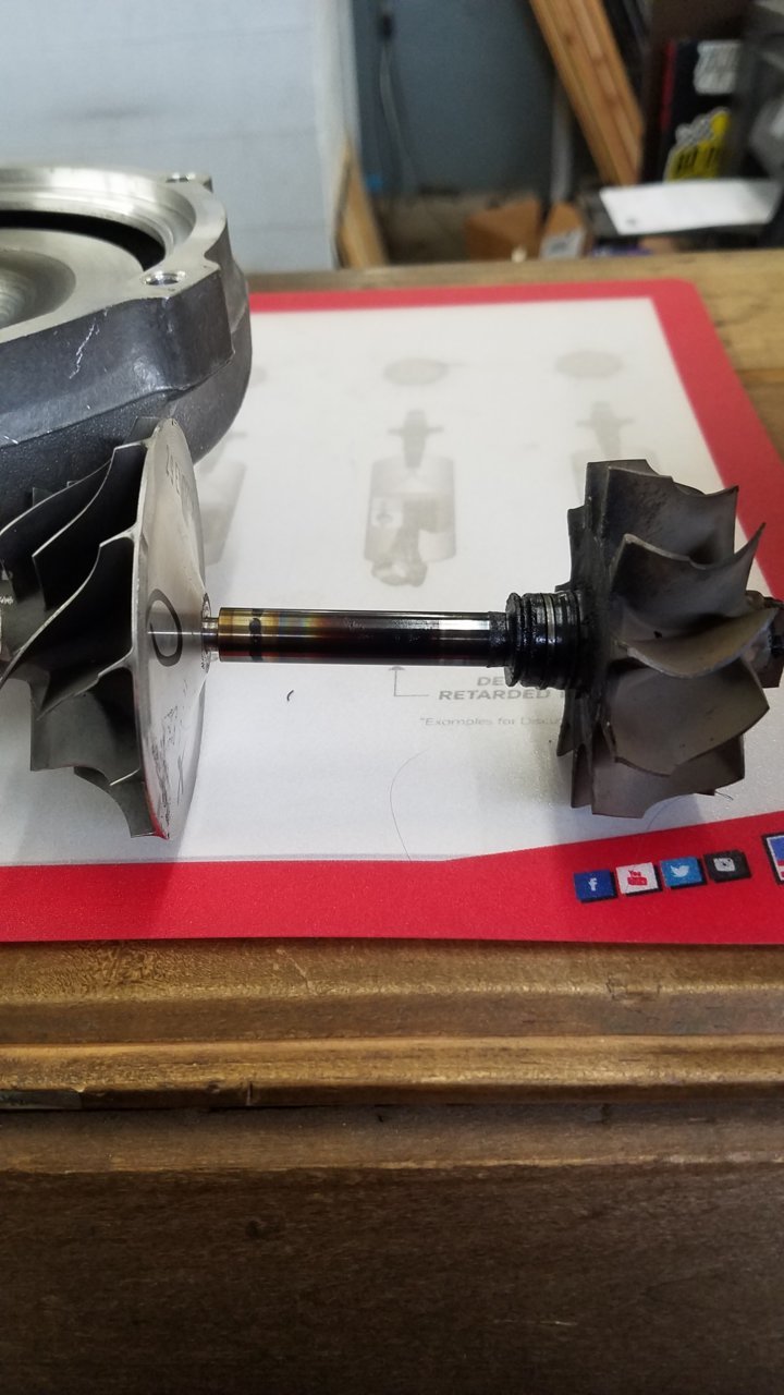

    Clearly a leaking problem. The oil is caked up, around the seal. What I am also curious of, is was the clocking of the center housing too many degrees from "0"? Causing a draining issue as well?
    Off clocked, and turning off an engine immediately after some boostage fun, can cook that oil in the center cartridge just the same, as an inconsistent feed problem.

    Have you looked at fuel trims? I would like to see the STFT

    When it ran everything in vacuum was set around -.30 v and now its at -.11-.12v just to not die and all I've done is swap in a new o2 sensor

    You mean reload the software on to the laptop? I think all I have saved is the stock tune that madtaco sent me and I have just made fuel corrections from there; never bothered saving it because it was just working, not working super well

    Both banks are going super rich and if the tune hasn't changed then I would assume the interface/interceptor to the MAF has an issue? Has this been checked out?

    The only thing I have changed is the fuel table (and the new o2 sensor) it ran "fine" on the way home from work and has ran for several months with the check engine light on with this tune. I started pulling fuel across the table and everything went super lean and so I had to add back way more fuel than the rich tune I had before just to get it to run

    What do you have in your AFR Adjust table? You may need to tweek that table for the new sensor?

    Stock tune
