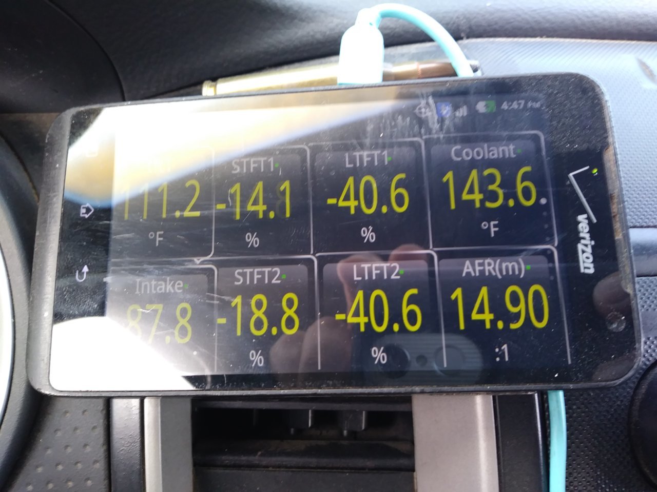

  14. Jul 14, 2018 at 3:28 PM
    #8074
    yota243
    yota243 Well-Known Member
    Aug 22, 2012
    #85267
    21,627
    E.J.
    north Alabama
    turbo 05 prerunner trd off road DC
    Bw s256 turbo with 3 in glass pack dumped pre axle raptor liner bed and top rails and fenderflares and rocker panels. Hunter side steps. Plasti-dipped upper fenders and emblems. satin black spray paint here and there inside and out. 5100's set to 1.75" up front . C channel front bumper. Maxxis bighorn 255/85/16
    I know this isn't quite up to temp but u get the idea (cel is back on for system rich and the o2 sensor code is pending)
  15. Jul 14, 2018 at 4:58 PM
    #8075
    tacodown
    tacodown Well-Known Member
    Dec 31, 2014
    #145303
    168
    brant
    holtwood, Pa
    96 tacoma 2.7
    Yeah from what I remember... I didnt clock anything it came ready to bolt on.
  16. Jul 14, 2018 at 5:27 PM
    #8076
    yota243
    Aug 22, 2012
    #85267
    21,627
    E.J.
    north Alabama
    %3 what? Duty cycle? Ft?
  17. Jul 14, 2018 at 5:35 PM

  18. Jul 14, 2018 at 7:03 PM
    #8078
    MadTaco461
    MadTaco461 BRO runner
    Dec 30, 2009
    #28470
    13,411
    CA
    99 turbo 5 lug long travel
    Kinda stock
    Fuel shift in trims.
    yota243[QUOTED] likes this.
