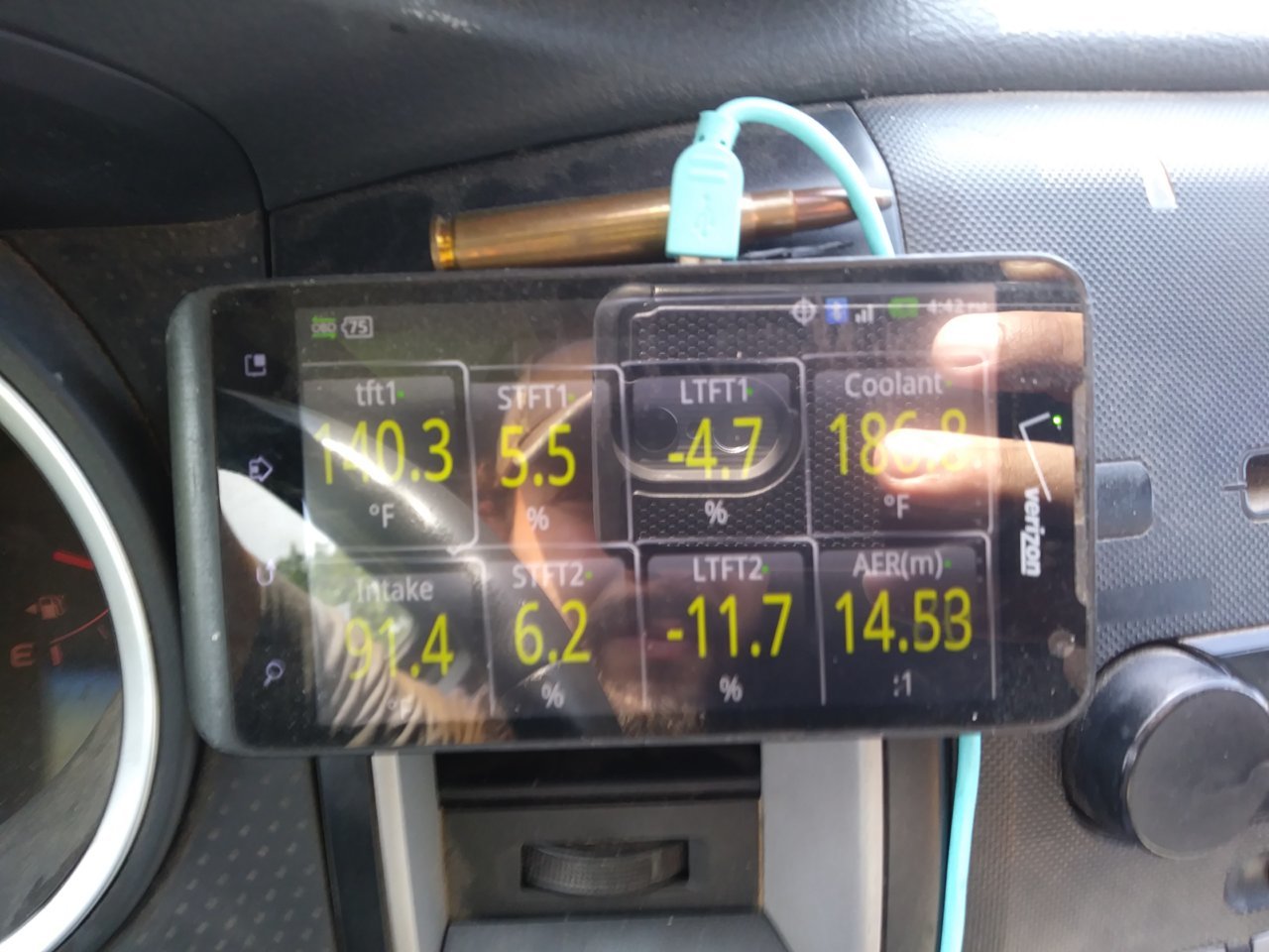

    I dunno yet I changed it in the parking lot at work. Ltft went down around -18 and stft are around +20 or were when I finished I figured I would drive a bit and see if it leveled out some

    What rpm range is it doing that at?

    ~600 I guess that's at idle

    Gettin there... Ride home was much better in at -.34 v in all my grandma driving zones

    What is LTFT 1 and 2 difference? I don't have that... those are liveable trims if they settle there.

    Bank 1 and 2 I'm pretty sure
