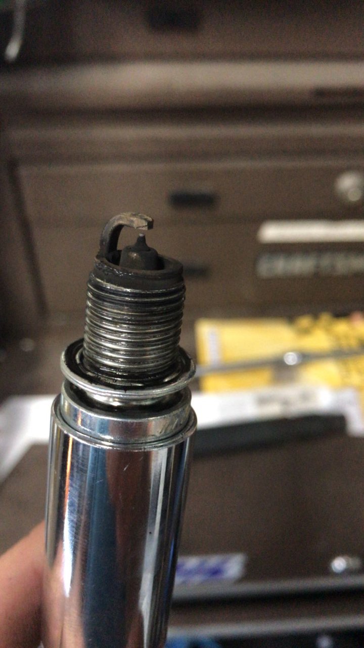

    I had a fouled plug cyl 3 idle is good again

    No it’s an error message ad soon as you connect the laptop saying functionality may be limited and yes i have an esp account.
    Here was the fouled plug

    Supposed to be close on the iridiums. Paralax from angle probably makes it look closer than normal too.
    That is really odd. Sounds like it is in 'Safe Mode' I am quite curious what the say about that and how to correct it.

    Bw s256 turbo with 3 in glass pack dumped pre axle raptor liner bed and top rails and fenderflares and rocker panels. Hunter side steps. Plasti-dipped upper fenders and emblems. satin black spray paint here and there inside and out. 5100's set to 1.75" up front . C channel front bumper. Maxxis bighorn 255/85/16
    Gotcha! I know mine is tight, .024, but I'm on e85 so it helps with blowout they say.

    Mine is .032 now
