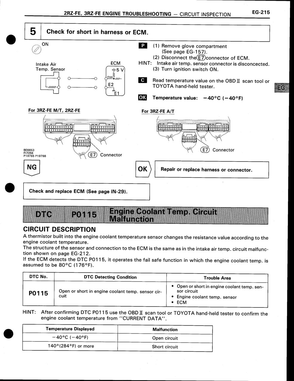

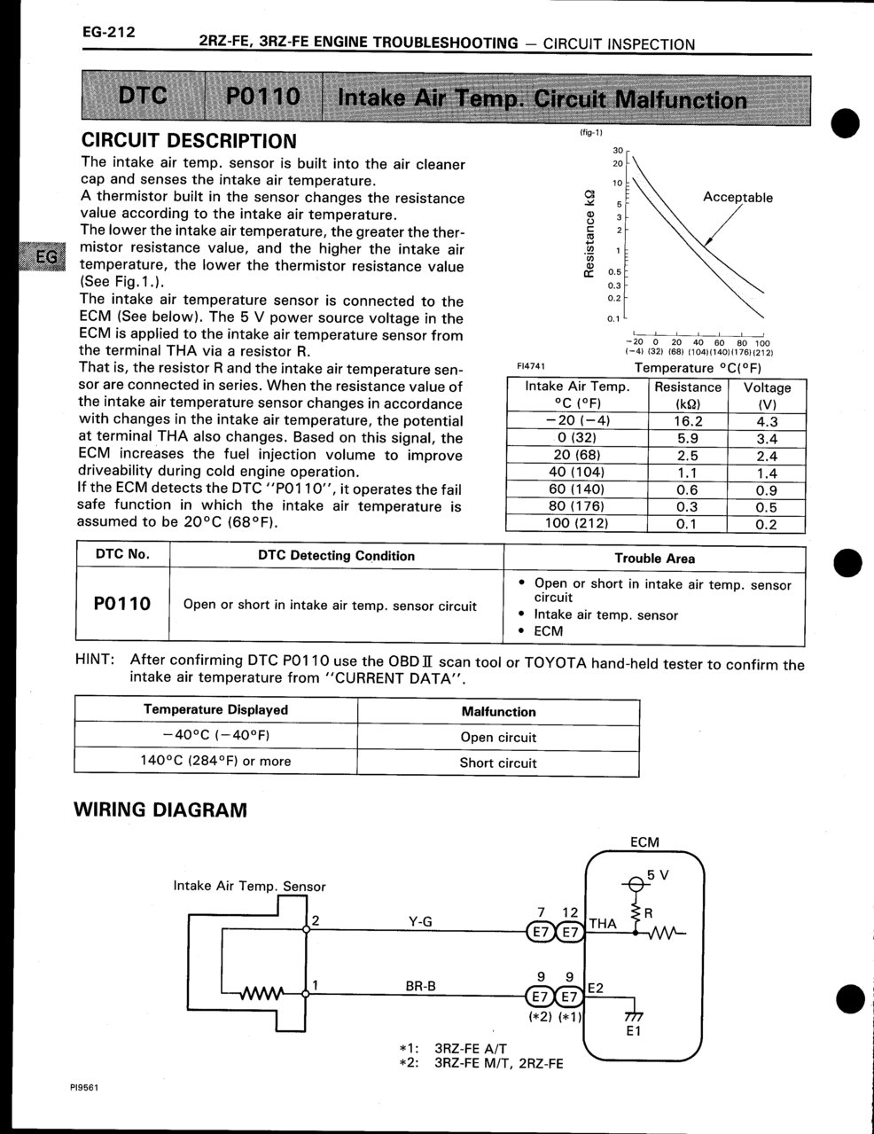

    you can check the sensor settings and adjust the curve. This is what was set in the map.
    Im not sure if they changed between years.
    the curves are the same for the IAT and Coolant temperature sensor

    Well i got the AIR TEMP sensor to work right this morning but the coolant temp sensor still is off even with the values for resistance from the IAT table. This morning my garage is 86 and the coolant temp sensor on the haltech was reading 132

    I did. Removed the jumper harness wires for the OEM sensor. Wired it to the new sensor.
    Because of that conflict between my truck and the Haltech both using that sensor, and the ensuing problems, I opted for the additional sensor. That way the Haltech had its own, and the needle on the dash, as well as the Scangauge still showed the coolant temps as well.
    I don't drive around with my laptop connected daily, so having my eyes on the real time data was also important for me. Otherwise, I could have just removed the OEM coolant sensor from the truck's usage, so only the Haltech used it.

    I think my scaling is just off i need to look it over some more.
