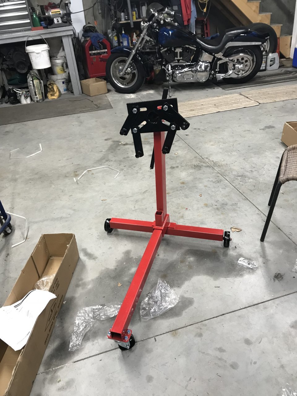

  4. Jul 23, 2018 at 11:32 AM
    #8244
    Jcyr
    Jcyr Midnightthetaco
    Mar 16, 2017
    #213447
    3,280
    Jack
    North east
    3RZ 04 4x4 black ext cab
    2.5" lift king/total chaos Skids sliders rear tire swing
    0B3B3705-88FD-4630-8E61-23E1F30C4E7D.jpg No tuning updates yet but i did put this together last night :spy::spending:

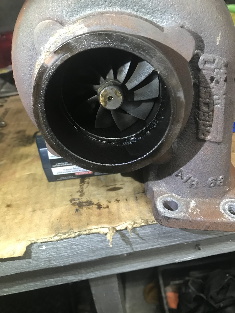

  18. Jul 24, 2018 at 1:27 PM
    #8258
    Jcyr
    Mar 16, 2017
    #213447
    3,280
    Jack
    North east
    Well Rob and Mark know but I’ll update everyone... my truck was smoking white yesterday when it got up up temp at idle.. no sign of oil in water or water in oil abd compression and plugs looked good. It doesn’t get worse with rpms so I don’t believe it is the rings. I think it smells like oil so my first suspect is the turbo. I’m going to pull it tonight and check it out and posibly bring it up to temp with no turbo to see if it still smokes

  19. Jul 25, 2018 at 4:39 PM
    #8259
    Jcyr
    Mar 16, 2017
    #213447
    3,280
    Jack
    North east
    Well thats the problem .. brand new turbo too :/
    05Taco4x4 likes this.
  20. Jul 25, 2018 at 4:41 PM
    #8260
    Jcyr
    Mar 16, 2017
    #213447
    3,280
    Jack
    North east
    Well thats the problem .. brand new turbo too :/4C679976-6C47-441F-B6CD-A18CFC3EEBFF.jpg
