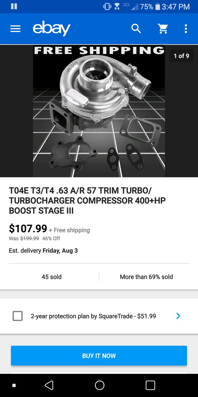

    It seems eBay might be in tune with what I've been searching haha
    MadTaco461 likes this.

    Hey that's my turbo!
    Speedytech7[QUOTED] likes this.

    For $107 you could blow em up every couple of months for fun haha
    tacodown and MadTaco461[QUOTED] like this.

    Unfortunately mine last longer than a precision.
    Torspd, Jcyr and Speedytech7[QUOTED] like this.

    This is sad haha. I imagine they're all pretty similar though until you go ball bearing
    MadTaco461[QUOTED] likes this.

    The eBay was suppose to give me an idea how to size a turbo on my truck for dirt. Also help with setting up the truck for boost. Was confusing to take something na and make it handle boost nicely. Rather ruin something cheap at first while I was learning.
