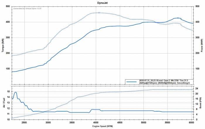

    On another note Kurt is up to over 400 hp and tq on his E80 3rz. That built block is awesome. That truck has gotta be fast now.

  11. Aug 8, 2018 at 8:07 PM

    I can't imagine how fast that thing feels! I think he said his limit will be around 430-460 or so essentially based on what his clutch will hold. Looks like he's already at that.

    That pull has gotta be nutty.
