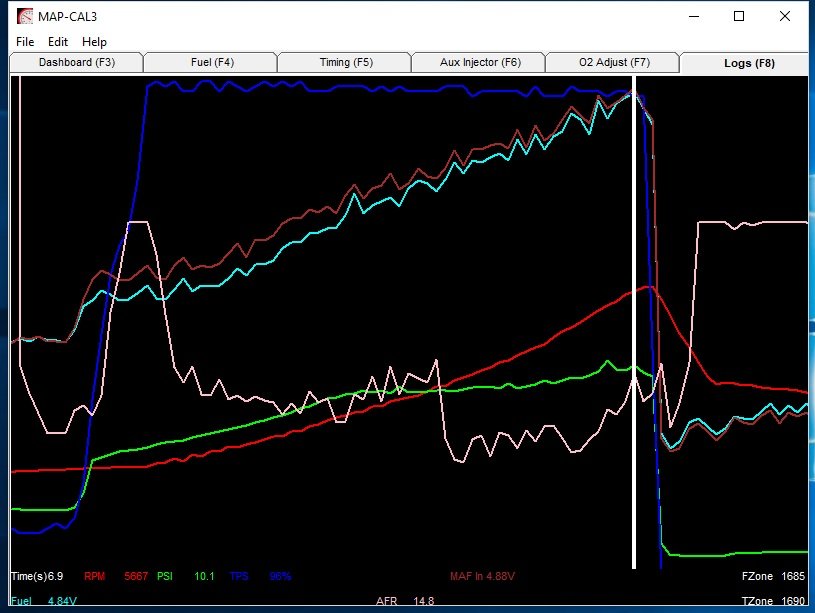

    Did a pull yesterday after playing with my tune. Man she went crazy lean right before redline :bananadead::anonymous:
    Running out of MAF too. Can't fatten her up top anymore or I'll hit fuel cut. She angry. Time for some larger injectors asap.
    At least I was pulling a bunch of timing.
