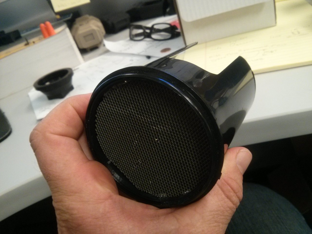

    Just noticed you’ve got you’re MAF Sensor post turbo.
    Have you tried to put the MAF Sensor pre turbo? It may net better results since the ECU is currently reading the amount of air in that’s under pressure. Should the MAF be preboost, it would be the true atmospheric amount of air. ??? Makes sense in my head anyway.
    MadTaco461[QUOTED] likes this.

    you can do either. i ran pre-turbo on my old car.
    Brake Weight[QUOTED] likes this.

    I can control the fuel electronically so it doesn't matter where I put the sensor. For my setup it is easier to run the maf sensor as shown. Theoretically it doesn't matter whether you run the maf sensor pre or post turbo. You are just measuring the mass of air flow. It just happens to be less dense in front of the turbo. You might just have a slight confusion between mass flow rate vs volumetric flow rate.
    Torspd likes this.

    I used that same one on mine running the MAF post turbo and didn’t have any problems with it. That one is aluminum making it less likely to break than the plastic ones out there. The only small issue I had was that it doesn’t have a bead on the ends of it so it slipped out of the coupler one time over about 1.5 years causing a boost leak.
