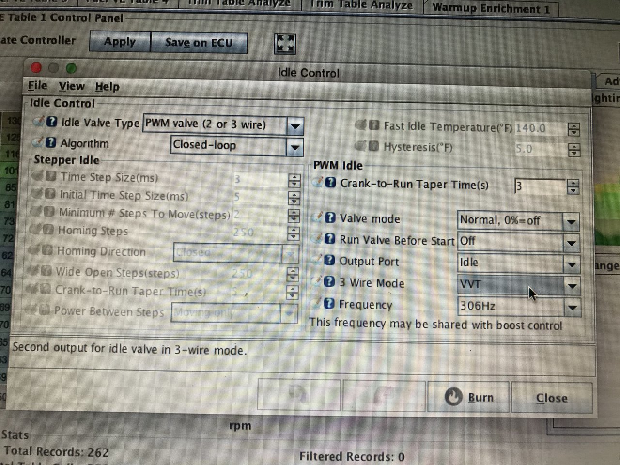

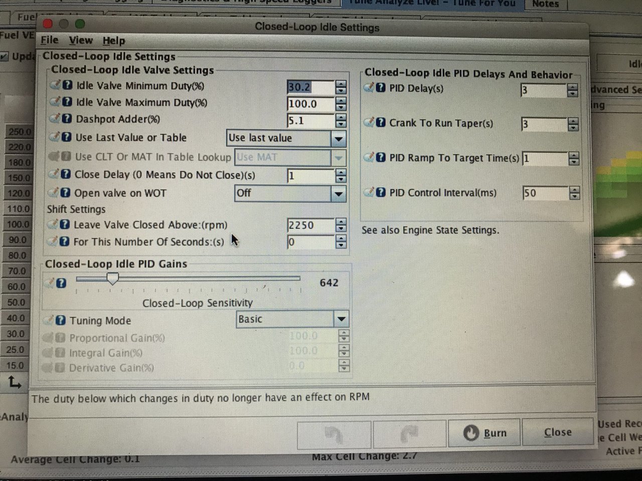

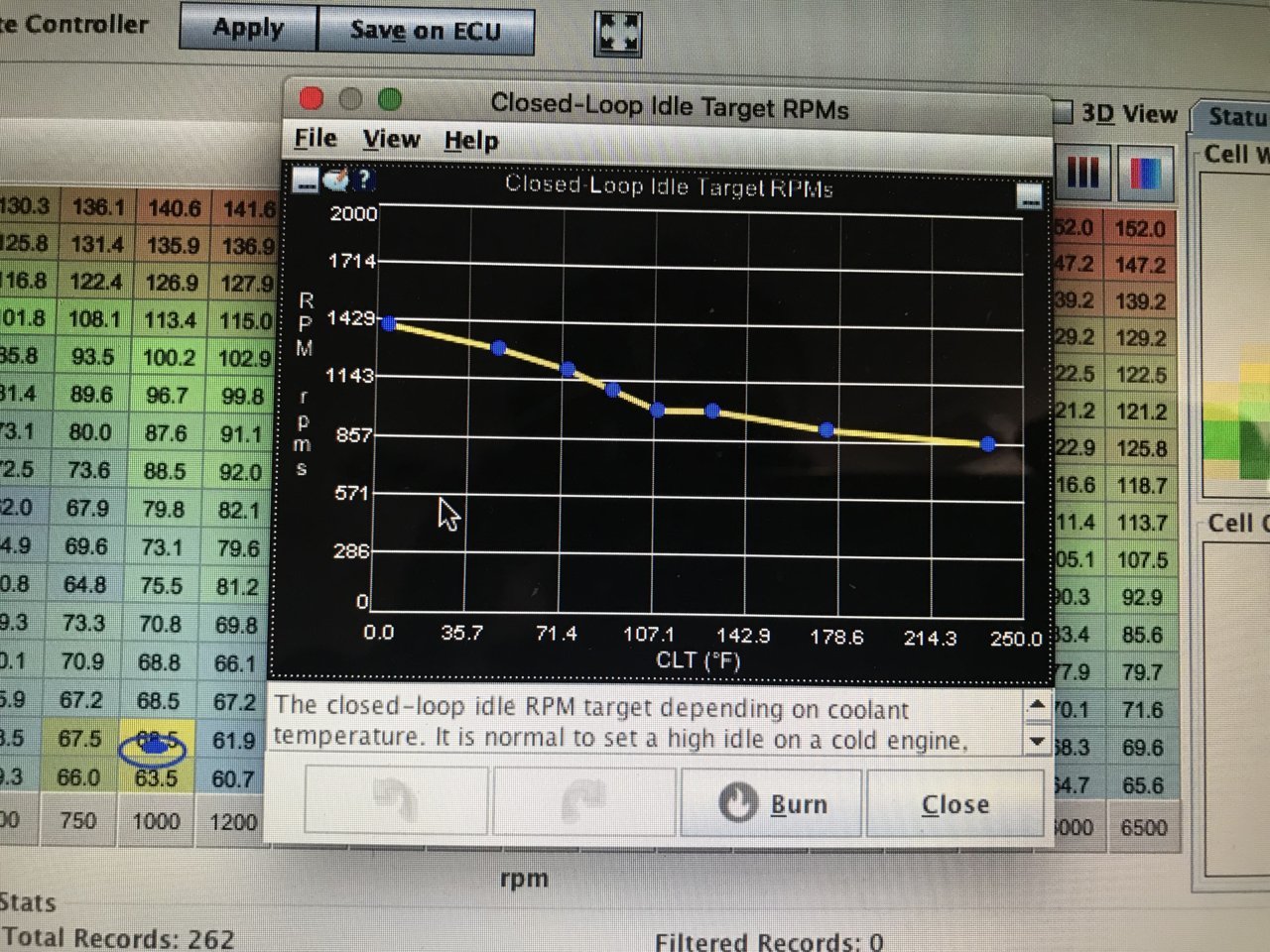

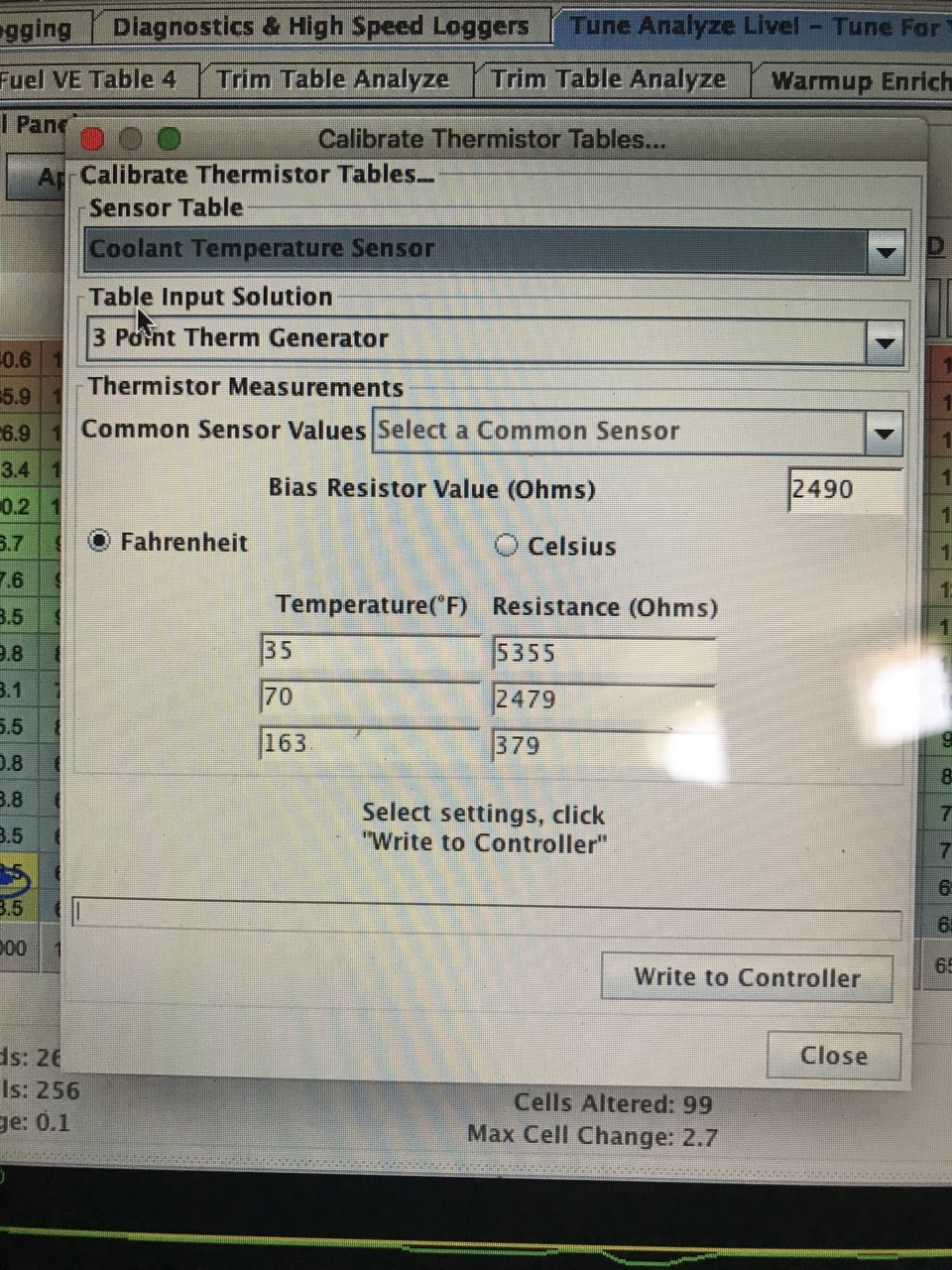

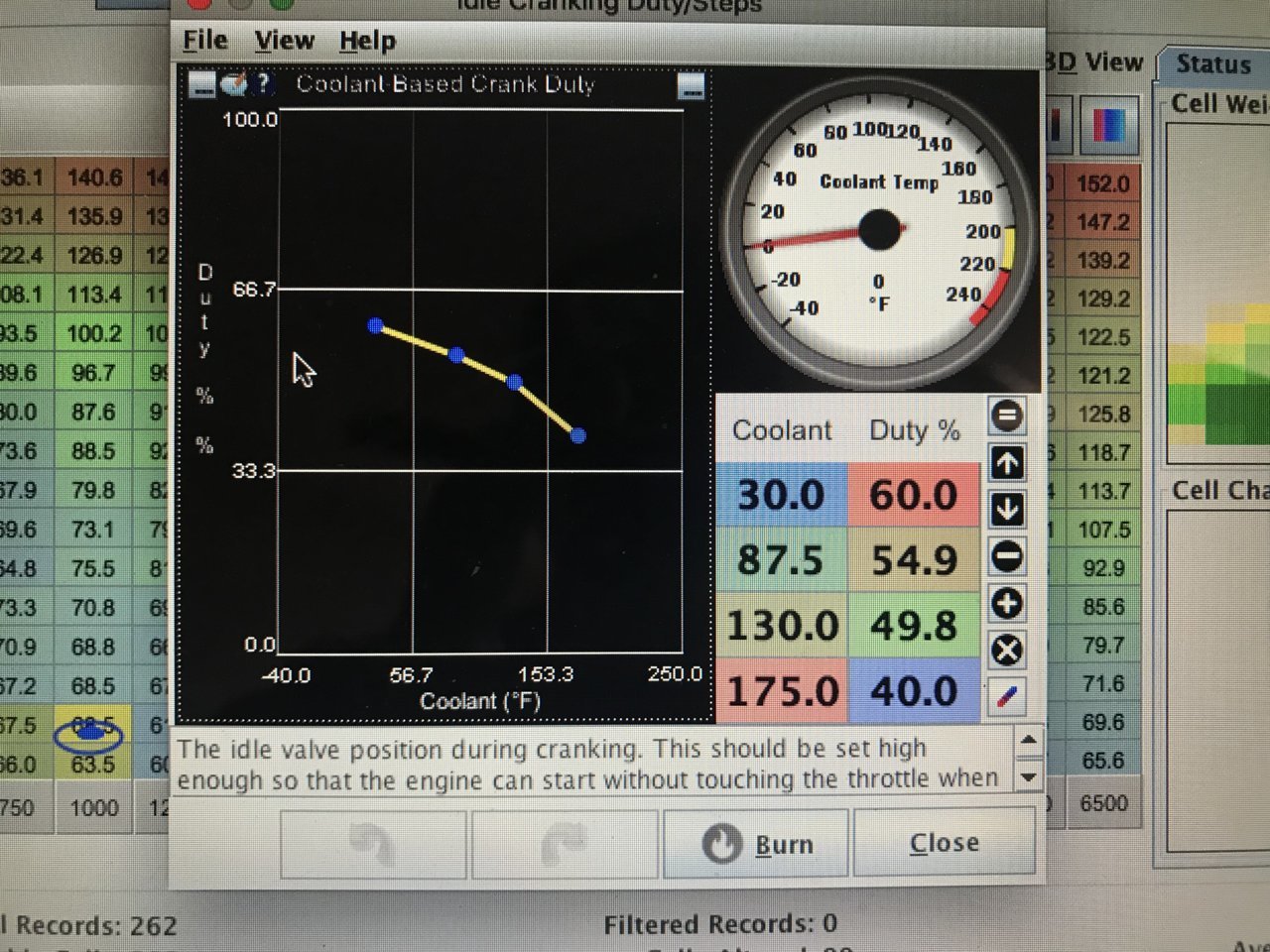

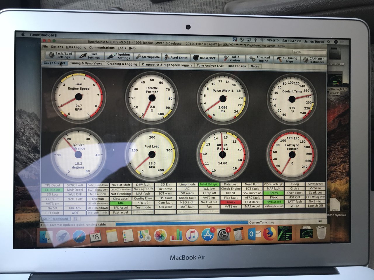

    I was also able to get the idle functioning properly as well. Turned out I had it wired correctly, I just needed to make some changes to my settings. In the Idle Control screen I needed to change the box 3 Wire Mode to VVT so that it it would see the VVT wire as an PWM output in order to be able to close the valve. I then recalibrated my CTS as well as my TPS since they were a little off. I also entered some different values for the crank up settings as well. This is set up now to control idle through closed loop tuning. Here are some pics of my settings. Idk how these compare to screens in the Haltech but hopefully some of it may transfer over. The last 3 screens I didn’t alter but thought they could be helpful to someone.

    The truck runs a lot better now. Since I put the smaller pulley in it, it pinged like eff in boost and in open loop, AFR’s would drop to 10’s making it bog. Now with the timing map I’m running, the truck is WAY more responsive out of boost and much torque-ier as well. It pulls much better in boost as well. The main tuning area I need to figure out is when I’m cruising on the freeway and stomp on it to get into boost, the AFRs drop to 10.2 for not even a second before hitting high 11’s to low 12’s. I not sure why it’s doing that but it causes the truck to hesitate a bit. That never happened on the turbo truck. Not sure if that’s a tuning issue or something else.

    My guess would be that it's an acceleration enrichment setting that is too high, so it's adding too much fuel when it sees the change in the TPS.

    That would make sense. I’ll look at that when I get a chance. Thanks for the suggestion.

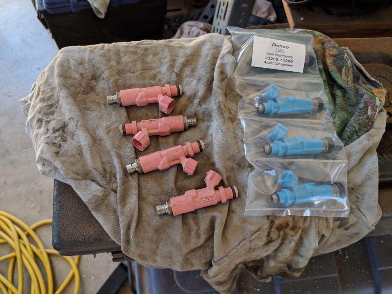

    Pulled the pinks. Going to try the 550s

    Nice. Where'd you get those from? How much larger can your MAP3 tune for?

    This is as crazy as my mapecu can do. They say they can do 200% of stock. I think they are rx8 injectors. I have the part number. Got it from an eBay seller called clean injection. I post up how tuning goes.

    Are these plug ‘n play?

    2tr is a different injector. They have a long style nozzle. I'm sure there is an off the shelf one that flows higher. Hit up fiveomotorsports see if they have ones that flow more than stock.

    What are the pinks supposed to flow at?

    Totally. After posting I started thinking and figured it had something to do with wiring. As soon as I pulled the glove compartment off, I saw two exposed wires. Made for a quick fix.
    I did a little more around town cruising speed, stop and go tuning with the Megasquirt VE Autotune function today. Smoothed out some areas and made down shifts and transitions through turns closer to seamless. It’s a really cool feature for that.

    I think around 330cc
