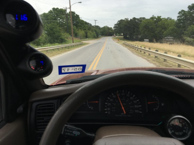

    Maybe my gauges arent right I just took a picture full throttle coming home from work

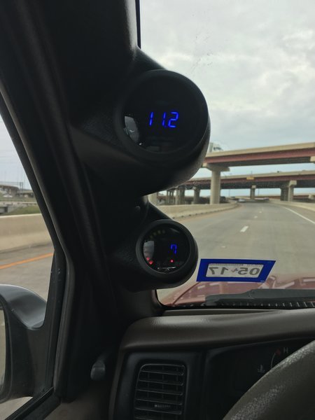

    Here's a better picture

    At WOT he's running on open loop, so the ECU is not trying to control the AFR and is just dumping fuel based on MAF and who knows what other parameters. Also, he's in a 1st gen Tacoma which seem to handle adding boost a lot better than the 2nd gens from what I've read.

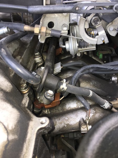

    Here's my injectors 2 brown and 2 grey this got me nervous don't want a blown engine guess I'll put the 4.83 spring inIMG_5577.jpg

    You guys are going to kill me for this but I don't have the wideband AFR yet could this narrowband be giving me false readings

    That gauge mounted on your pillar sure looks like a wideband to me.

    No it's narrow I hooked it up to the upstream o2 before the cat

    Interesting. So you just tapped it into the factory sensor? Never seen that done before. What kind of gauge do you have it hooked in to?

    Yes I spliced into the upstream O2 sensor blue wire it's a glow shift narrowband AFR I read up on this and most people said it wasn't accurate at least it's not as accurate as wideband narrowband gives you 10 different readings as opposed to wideband 50 different readings or something like that hopefully others will get in on this for better information

    Narrowband sensors are 0-1 volt and Wideband sensors are 0-5 volt. Here's a good article on the two different sensors (http://www.innovatemotorsports.com/resources/news3.php).
    The stock wideband signals on the 2nd gen are a current based, so you can't just tap into them like the narrowband. That's also why we have to use the AFR module with the mapecu3. If they were a voltage based sensor, you could tap into it, and the mapecu3 could send adjusted signals directly to the factory ecu.

    @Jstand
    Is it that the plugs are just different colors and not the injectors themselves?
    If you didn't ever mess with the injectors, then why would they come from the factory mismatched in flow?

    These are the original injectors I bought this new in 2000 not sure if they are mismatched but I'm just thinking now why mess with it if its working I just don't want to end up with a blown engine

    So then the likely hood of the injectors being different is slim to none. Most likely the connectors are just different.
