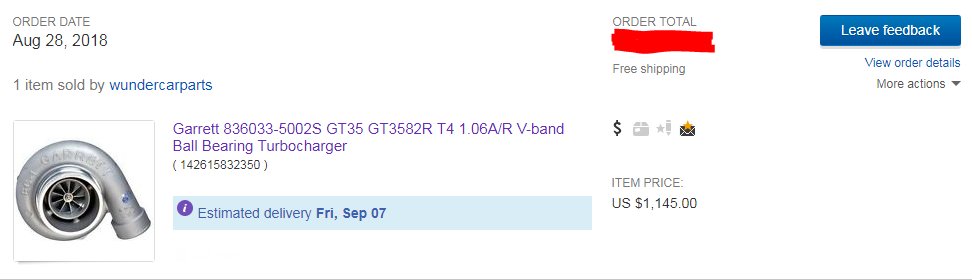

    Ok what turbo should I buy and from where for my 3.4L V6? Ebay has Precision and Garrett for about $1500 that's about my budget. Ive gone through 2 Chinese ones I'm done with that. Any suggestions here? I need oil and water cooled 3" vband.

    Could hit up boost lab. They have pretty good pricing on nice turbos.

    2013 DCSB 6MT, 2004 4runner
    Borg Warner turbos are supposed to be the shiz
    j0shu4[QUOTED] likes this.

    I looked up that boostlab they looked good but I'm not sold. I have turbo ptsd

    Some of those Precision are like $5k wtf? No thanks. Not a 6 second car.......
