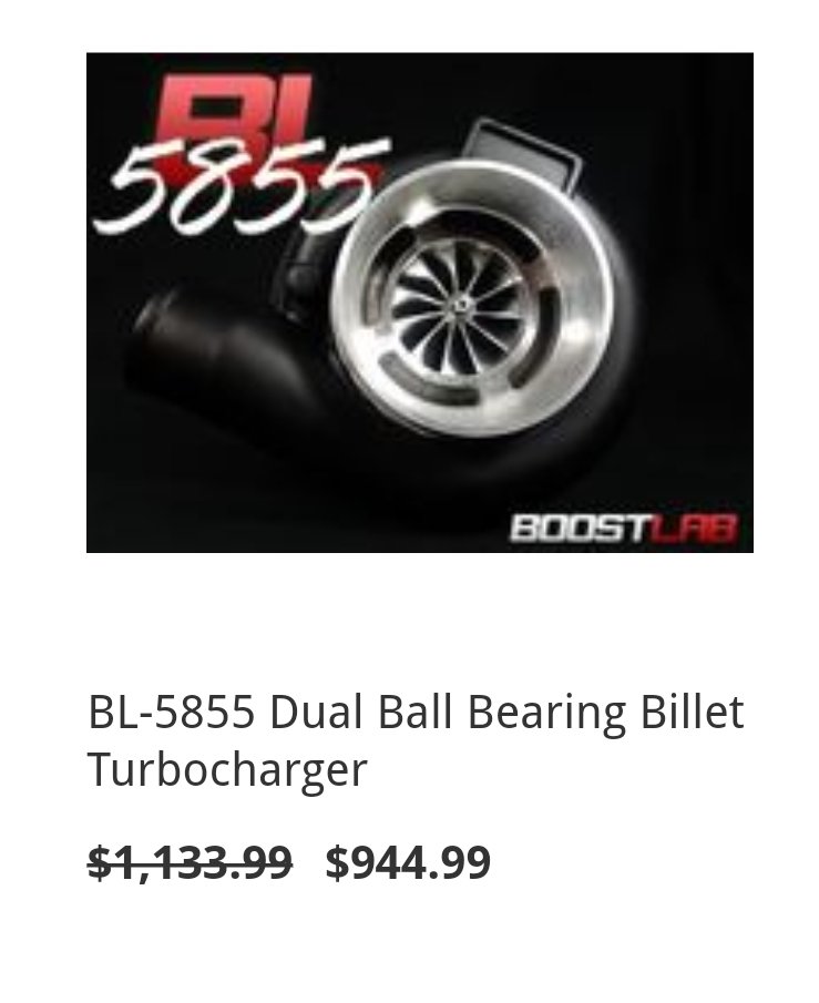

    Went with this one. I'm excited it should be way better than my last one. Also upping to a 10lb spring on my Tial so I'll be pushing 10 psi minimum but will try and max out my current fuel system. Might have to get bigger injectors and pump hopefully the FIC6 will handle it. Already running 42lb inj and the Denso supra TT pump making 350ish tq/hp. Hopefully get her up to 20psi and see what numbers we'll get. Should spool quicker too around a 55 to 65ish compressor and impeller with smaller A/R housing. Apparently these BL turbos run the same internals as Garrett and Precision and are balanced on the same type of balancer in house by Boost Lab.Screenshot_20180905-102608_Chrome.jpg

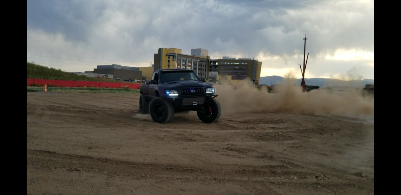

    I miss my Taco. And with winter coming I need her.

    The improvement should be interesting to hear from you.
