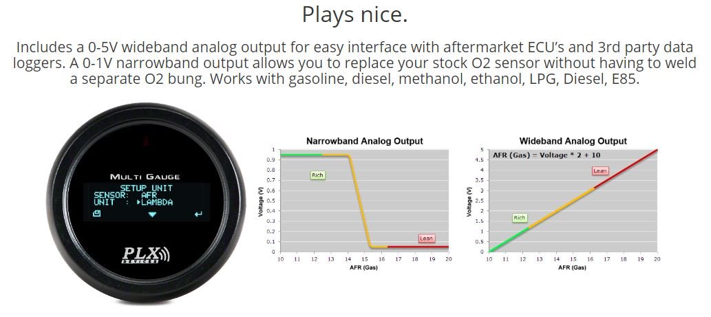

    I already purchased this, back when I was fooling around with the DIY Supercharger
    https://www.plxdevices.com/SM-AFR-Gen4-Wideband-AFR-with-MultiGauge-Link-p/897346002870.htm
    This link says it has analog output- I don't have that gauge, was just using the phone app.
    https://www.plxdevices.com/PLX-Wideband-O2-Air-Fuel-Ratio-Sensor-Modules-Gauges-s/125.htm
    I think I'm gtg, this installation pdf says just connect a single wire to ecu
    https://www.plxdevices.com/v/vspfiles/support/user_guides/SM-AFRGen2_user_guide.pdf
    edit:
    So now I'm thinking this thing is the equivalent of the WB1 lol

    I have the same WB gauge in my truck now. Before installing the Megasquirt I was using it with the narrowband output to the ecu. It was pretty simple. Basically just run a wire from the top left connector on the afr module to the stock ecu’s OX wire at the ecu plug. You just de-din the stock wire form the ecu plug and insert the wire from the old module in place of it. Truck fired right up.
    Edit: just read your other posts. Saw that you’re wiring to the Haltech. Idk how that works. My MS has a O2 wire that simply connects to the wide band output from the plx afr module. The bottom right pin
    05Taco4x4[QUOTED] likes this.

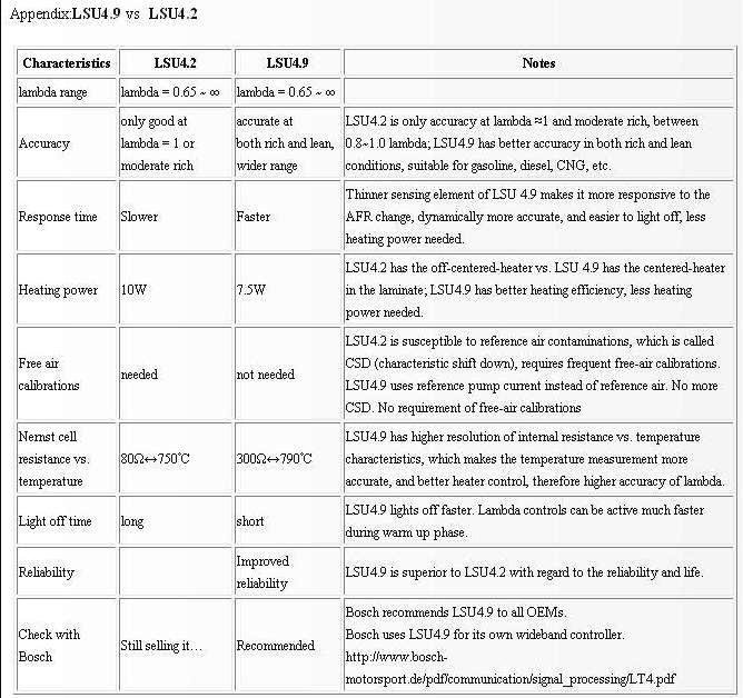

    PLX uses LSU4.9 (piezoelectric)
    I purchased the PLX last year because the LSU4.9 is the "new thing", didn't quite understand all the whys at the time but clearer now:
    Faster
    No calibration needed
    Accuracy across range
    Longer service life
    Think I lucked up
    Torspd, MadTaco461 and boostedka like this.

    4.9 is the shit. AEM and depo racing use the same sensor also. It's fast. I've been running mine since 2014.
    05Taco4x4 likes this.
