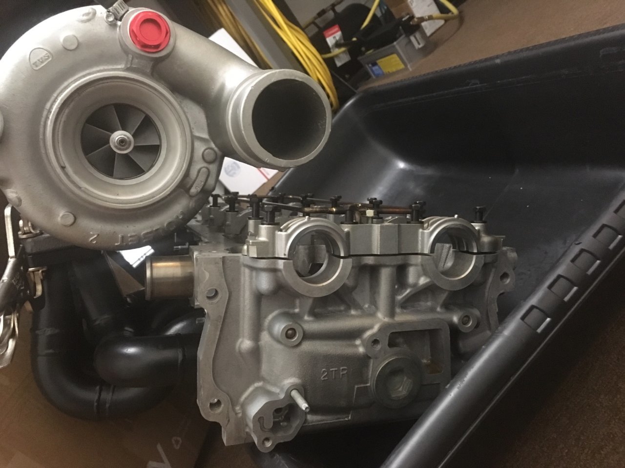

    Sooo I’m putting this out finally. This will help with my down payment for my next vehicle or may start to fund for my next turbo project. Will have time to post it up today after work...here’s a reasonable asking price.
    1100 for hotside minus WG. 1300 With WG and all springs included.
    Some info regarding hot side, I had bungs installed for rear o2 sensors so both front and rear sensors can be used. Welds are not pretty but they do not leak. Because of my truck being an auto, the driver merge crossover tubing near the trans Pan was pressed a little to clear from rubbing. if installing on an auto, you will have to either bend your trans lines to clear or get them rerouted. If you have any questions please feel free to ask.
    This does not include shipping...
    I will update with photos once I get home from work.
    Edit: forgot to mention that due to the many heat cycles it has gone through considering it was daily driven, driver side and merge collector vband a may need new vband. I will double check. If I recall, I think I had orders new ones but I don’t remember when I boxed them up.

    Is that the Oz Boost/chinese manifold or did you build it?
  20. Sep 20, 2018 at 4:37 PM
    #8780
    05Taco4x4
    05Taco4x4 ToyotaHubs
    Jun 29, 2011
    #59085
    6,223
    2TR-FE Enthusiast
    FJ Tcase, Manual Hubs, 2017 Head unit, Mirror Riser
    Direct from Hong Kong Shanghai, they welded one with a T3 flange for me :D
